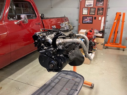

Andy AKA Andy's GT stopped by and was helpful in getting the motor back into the 83 D150.
It is a long reach dropping the slant back in to the 83 D150 and it is helpful to have a person up top working the hoist and someone down at the transmission guiding it back in place.
Spent the past few days re installing the: alternator, power steering, radiator, exhaust system, belts and hoses.
Originally I was only planning on fixing the clutch and maybe changing the cam, did that and a lot of general under hood cleaning.
I drained the a833 and need to get the lube to re fill it, other than that I believe I have everything. Tomorrow should be the day I get it re started.
