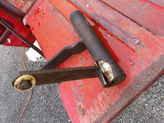

Clutch kit {MU15251} installed two years back, 1983 D150, maybe 2500 miles on it. Would a failing pressure plate cause the adjustment
to go out of wack? I know all of these aftermarket parts are junk, but could something like this happen?

This was the issue.

I had a similar problem..
Those can be fixed!
https://www.slantsix.org/forum/viewtopi ... A+body+bar

They're nice people over there, had everything I needed. New torque lever with bushings.

I've cut the arms off and rewelded them to a "new" hunk of pipe before, to solve that problem.
