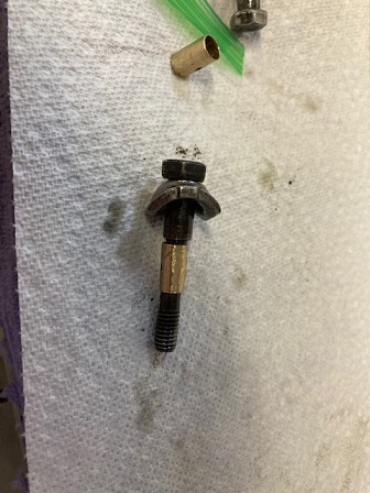

I did not restrict the oil flow to the head as part of the build process, so I am backing into that by using a brass bushing at the rear oil feed rocker arm bolt.

installed the hydraulic rear rocker shaft with a bushing that reduces the oil passage clearance. My visual observation is that I did not see a difference in the oil flow to the top end. But directionally this seems to be the right thing to do, although certainly the way things are I do not see oil starvation valve train issues in my immediate future :D . I will take the recommendations that I drive the car, break in the motor and re evaluate from there, so that is what I will do. Thanks for the recommendations.
