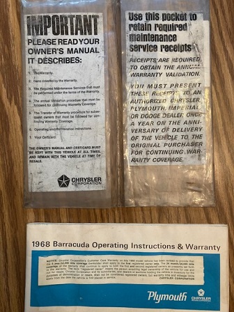

I have insurance on the 68B starting 7/15/21 and will visit with the IN BMV early next week to get a license plate on the car.
Going into the files to find the title I also got out the cars owners manual that was in the original plastic pouch in the glove box of the car when I purchased it in 2009.
The owners manual lists the: buyer, date sold, dealership and the salesman. There is an interesting warranty disclaimer on the pouch, to keep the warranty in effect the cars owner must present all receipts for service and repairs to the dealership on the anniversary of the sales date.
Also on the warranty book is a statement that the Chrysler Corp 5 year / 50,000 mile warranty is valid only for the original purchaser. The second owner has a 24 month / 24,000 mile warranty
