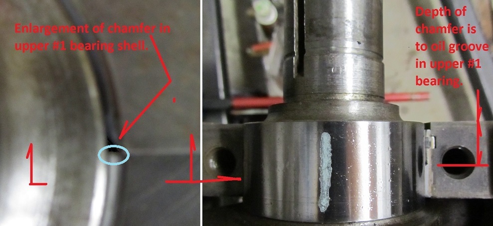

My primary question at this point is... if I am removing the #1 bearing cap to inspect/clean out that chamfer, and find the upper bearing DOESN'T have the chamfer, is there a technical/engineering reason to not put the chamfer on the LOWER bearing cap since I've got it off anyway? (ref: blue circle in attached photo). I fully admit I'm not an engineer, but I have a fair amount of common sense and this seems (particularly given the tiny surface area being affected), like it couldn't have any real negative side effect, and prevents the need to take the crank out of the motor!

My primary question at this point is... if I am removing the #1 bearing cap to inspect/clean out that chamfer, and find the upper bearing DOESN'T have the chamfer, is there a technical/engineering reason to not put the chamfer on the LOWER bearing cap since I've got it off anyway?...
The top bearing insert has the oil feed groove and the bearing's locating tab, facing forward so it is just easier to add the chamfer to that bearing half when the bearings are not installed.
There is no reason why you can not add this oil pathway to lower bearing half but just go forward with the chamfer, from where the top oil groove meets it. (just chamfer 1/2 of the edge, away from the tab)
It is also a good idea to drill a small hole through the top timing sprocket to let oil exit from the front cam bearing to the front of the sprocket and be sure to use an oil slinger.
The #1 tip... degree-in the new timing set and add 2 degrees of cam advance.
Understood on the chamfer being only the front half! Definitely cautious wherever affecting oil pressure is a factor.

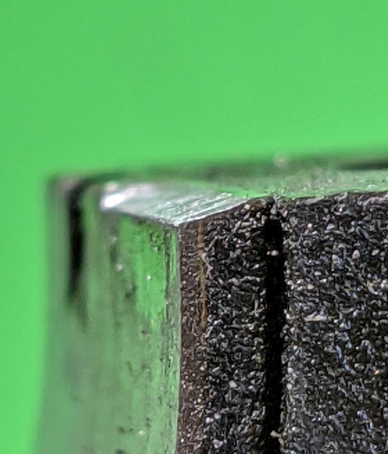

So I took the #1 cap off this evening and found no chamfer on any of the main bearing edges. I placed a small chamfer on the lower bearing as previously discussed (yes I cleaned up the shavings!) And retorqued the main bearing. Crank still spins nicely. Now the question is... When I fire this up the first time, is there any reason I must install the timing cover? I'd like to actually see if the oiling is working... Or not... Before I button it all up.
