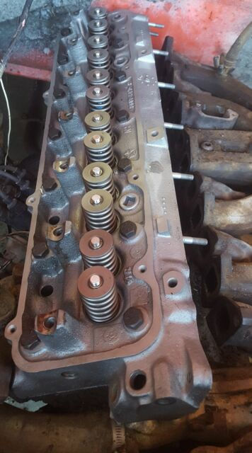

I have learned a couple of things about how to remove and install the manifolds, and also noticed that the gasket is so thin, like paper, it could be cut easilly with a knife. Out of curisoty I did a VIN search online and found a 5 year-old for sale ad showing the rebuilt head bolted to the engine. In the picture you can see the mnifolds were pulled back from the head and not separated. The mileage is very close to what is on the truck now, After watching a couple of YouTube videos I am pretty certain keeping the manifolds loosly bolted together is probably important to be certain the fit to the head is tight and properly sealed. Checking to see how the manifold studs were troqued I found on nut that would not torque to 10 Ft Lbs. The threads are stripped. All of the studs will be replaced with new when I put the new gasket in.
