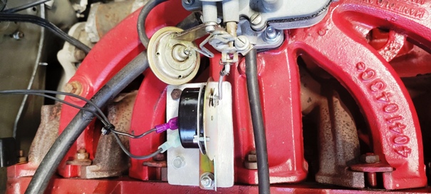

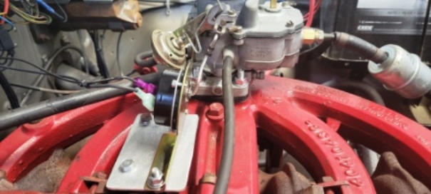

After fooling with a manual choke cable for a year, I decided to use the 1232 choke on my hard starting Valiant. Unfortunately for me, the vacuum pull-off is mounted on the side of my 9447 Carter, blocking the rod from the choke assembly when mounted on manifold location. :(
I made a plate to move it slightly back and toward the head, and bent the mounting bracket to lean slightly forward. This gave me a straight shot to attach the rod, but the angle didn't allow full rotation of the butterfly.
I reversed the plate I made, moving the choke assembly in front of the vacuum pull-off.
Next I bent the actuator rod to attach to the carb, making sure it moved freely. I also placed a stainless washer on the rod where it goes into the actuator body to keep it moving in a straight axis, using new speed/push nuts to keep the rod in line with the actuator body.
Works great, car starts immediately! :D

Good work getting it working. That № 1239 is intended for 383-440 motors; you might have had less work on your hands with a № 1232, which has a bracket configuration intended for use on the Slant-6 with a 2-barrel carb.
Checked my receipt, I did use the 1232, it wouldn't clear the side mounted vac pull off on my carb.
I did see the pics posted earlier, but didn't notice that carb has a rear mounted vac pull off.
at any rate, it works great!
