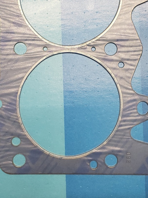

PostPosted: Tue Jan 11, 2022 4:30 am
I said from the start that it won't make much difference.
But, why not use a more accurate number when it's available?
