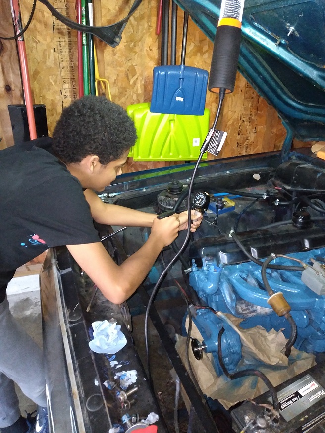

Yesterday I taught Logan how to perform a compression test. I did the #1 cylinder, he did the other 5. All were between 155-165 PSI. After that he installed the spark plugs (thanks again guys for the advice on getting the correct plugs!). I looked for the engine ID pad on the block, under the #1 plug hole, but couldn't see it. The head, at least, is a '79 or '80, maybe the block too. I'll have to see if there is a casting date somewhere on the block.
At the Holley Moparty we bought a fan shroud for an 18" radiator, doesn't quite fit, about 1/2" too tall to allow all 4 screw holes to line up. We started checking the new radiator hoses we got from Rock Auto, lower will work fine, but I suspect the radiator is not the original. The Dart is a factory A/C car, but missing everything under the hood. Bought the upper hose for an A/C car, but apparently the top radiator outlet should be on the right side, the Dart's is on the left. There are two sets of numbers on the top tank: 38086 & 3692913. Did some research last night, the radiator is for a '74 A body 318 Manual 19". Looking at the pics on Rock Auto they don't seem to curve in the correct direction. Guess I'll try to find a flex hose locally.
File comment: Grandson performing compression test

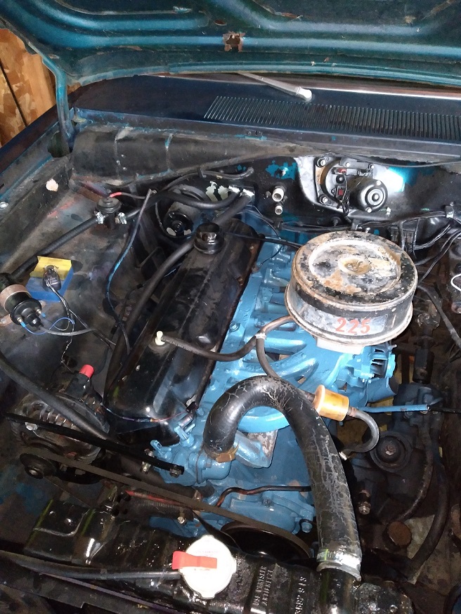

We actually got it running today, after dealing with a leaky thermostat housing gasket. Filled it with water (again) and it still leaked, but not as bad. First time was because the thermostat slipped during the install, dropping into the gasket area. Went and got another gasket, which had an adhesive side, so I know it didn't slip this time. When we take it off next time I'll reface it with my belt sander.
As it was a slow leak we started it up, let it warm up, and worked on setting the timing. Its been a while and I forgot to disconnect the vacuum advance. When I did it died as it was hooked to direct vacuum, not ported. Got it running again, got the timing close, and tried to adjust the carb mixture. I didn't get any change at all turning the mixture screw in or out. Once the weather warms up (next year) I'll try the old carb in the trunk to see if it's any better. The water has been drained out.
Might do more work on it if we get some slightly warmer days, but I'm not holding my breath. Will probably search for parts (like the correct radiator for it so we can use the correct hoses) and refinish the air filter assembly.
Chuckster
File comment: Back together and running

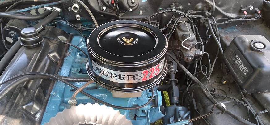

Here are pics of the powder coated air cleaner assembly, see a previous post for what it used to looked like. Swap meet air cleaner assembly: $10.00 - powder coating: $20.00 - decal $10.00 - air filter: Free (found in trunk - new) total = $40.00
