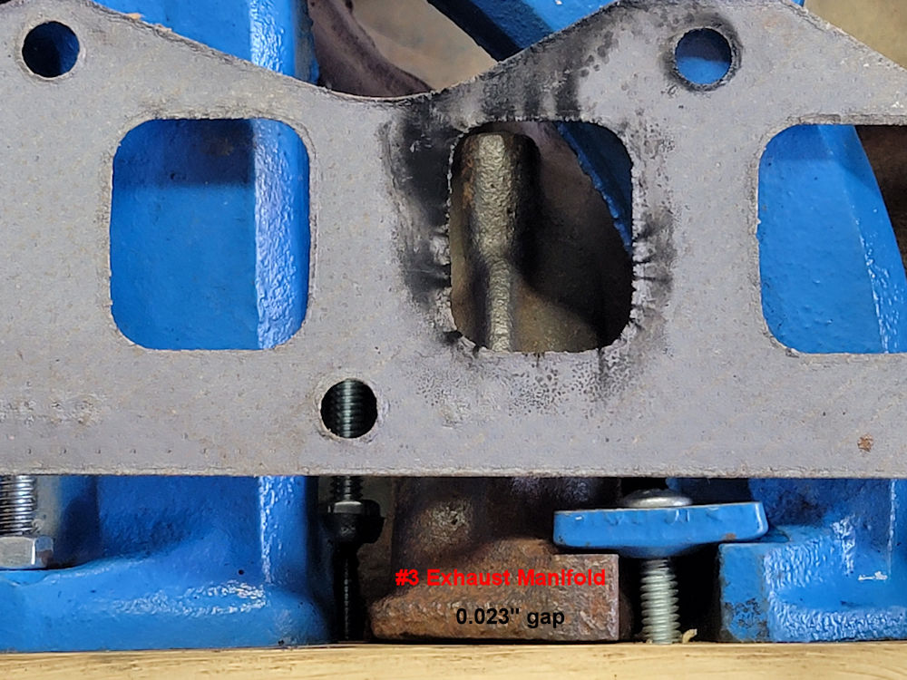

I immediately assumed a vacuum leak, which I do have, but after removing the gaskets I found that there was a gap between the manifolds, which means I did not tighten the three bolts tight enough. When I reinstall the manifolds I will tighten the 3 bolts evenly to about 35 Lbs. torque to make sure the gap is closed.
The new FEL-PRO manifold gasket had leakage around the number 3 exhaust port. I used the mounting board for the drill press jig I made to drill out the 2 broken bolts and mounted the manifolds to it. The number 3 exhaust flange has a gap of 0.023" between the board and manifold flange when all of the other flanges are tight to the board. I am replacing the FEL-PRO gasket with a Victor Reinz gasket when I reassemble the manifolds to the head. The thickest part of the FEL-PRO gasket measures 0.045", while the thinnest part of the Victor Reinz measures 0.066" with 0.074" maximum. When I reassemble the manifolds to the head is there any reason why I cannot use a thin layer of Permatex Red around the exhaust port to be certain there will not be an exhaust leak here again?
File comment: This image shows the gap between the #3 exhaust port and the mounting surface.

PostPosted: Sat Feb 12, 2022 3:00 pm
Posts: 25084
…is junk, in my experience.
Maybe too late, but it is very much worth your while to get the good gaskets for the manifolds-to-head and intake-to-exhaust junctions.

The Victor Reinz gasket I am planning to use is almost twice as thick as the FEL-PRO gasket. I am pretty sure it will seal all of the manifold ports, but I am not certain about the #3 exhaust manifold flange. The gap on my test mounting is .023", and the Victor Reinz gasket is about 0.030" thicker than the FEL-PRO. Even the little gasket for the EGR port on the head is a lot thicker than the FEL-PRO. I have researched to fine the Remflex gasket, but even on their site they did not list a gasket for the slant 6. RockAuto had the Victor Reinz gasket and gave the specs on the gasket. I measured it when it arrived, and it is much thicker than advertised. The Permatex Red RTV is rated for 700 degrees and exhaust is one of the applications given, which is why I am considering it as a thin filler. But I am worried a little about the seal not holding and blowing out. Maybe I should just put it all together again and see what happens. I am really getting tired of chasing the problems, and this is the last one.
To answer the question about how I am bolting the manifolds to the head, the 3 bolts tying the manifolds together are very loose when I torque the manifolds to the head. I plan to torque them to about 35 Ft. Pounds when I reassemble things and try to not have an exhaust leak there this time. The gasket shown in the picture was tightened too much and I planned to re=torque them. I think I will go a few Ft. pounds more with the thicker gasket to be safe.

You could double up on the gaskets if you need too. Is it just # 3 that is warped when you lay a straight edge across the manifolds?

I think I am going to forget using RTV around the exhaust manifold port. It seems to leave room for problems, if not at first then down the line. The picture I posted is the best way I have to put a straight edge along the manifold flanges. All of the other flanges are tight to the board with only number 3 exhaust showing a gap. The original gasket I removed the first time I tore things down had two exhaust leaks, but it was assembled to the head without having the three bolts that tie the manifolds together loose so who knows how the manifolds were set up then. They rebuilt the head without removing the manifolds from the header pipe because the bolts would break, which they did for me. I have wondered about two gaskets and will study that. the Victor Reitz gasket has a metallic filler on one side of the gasket thickness, which I will put towards the head and keep the softer side towards the manifolds.

Best thing would be to take the exhaust manifold (and maybe intake too) to the machine shop and have them mill/sand it flat all the way across. Doubling gaskets will help, but they will eventually blow out if the manifold(s) is/are not straight (planar).

Yes. Just have the manifolds machined flat and you'll solve the problem.
The factory torque spec for the manifold nuts is intended to allow the exhaust manifold to 'float' a little as it expands with heat. Over tightening them may eventually lead to a cracked exhaust manifold.
