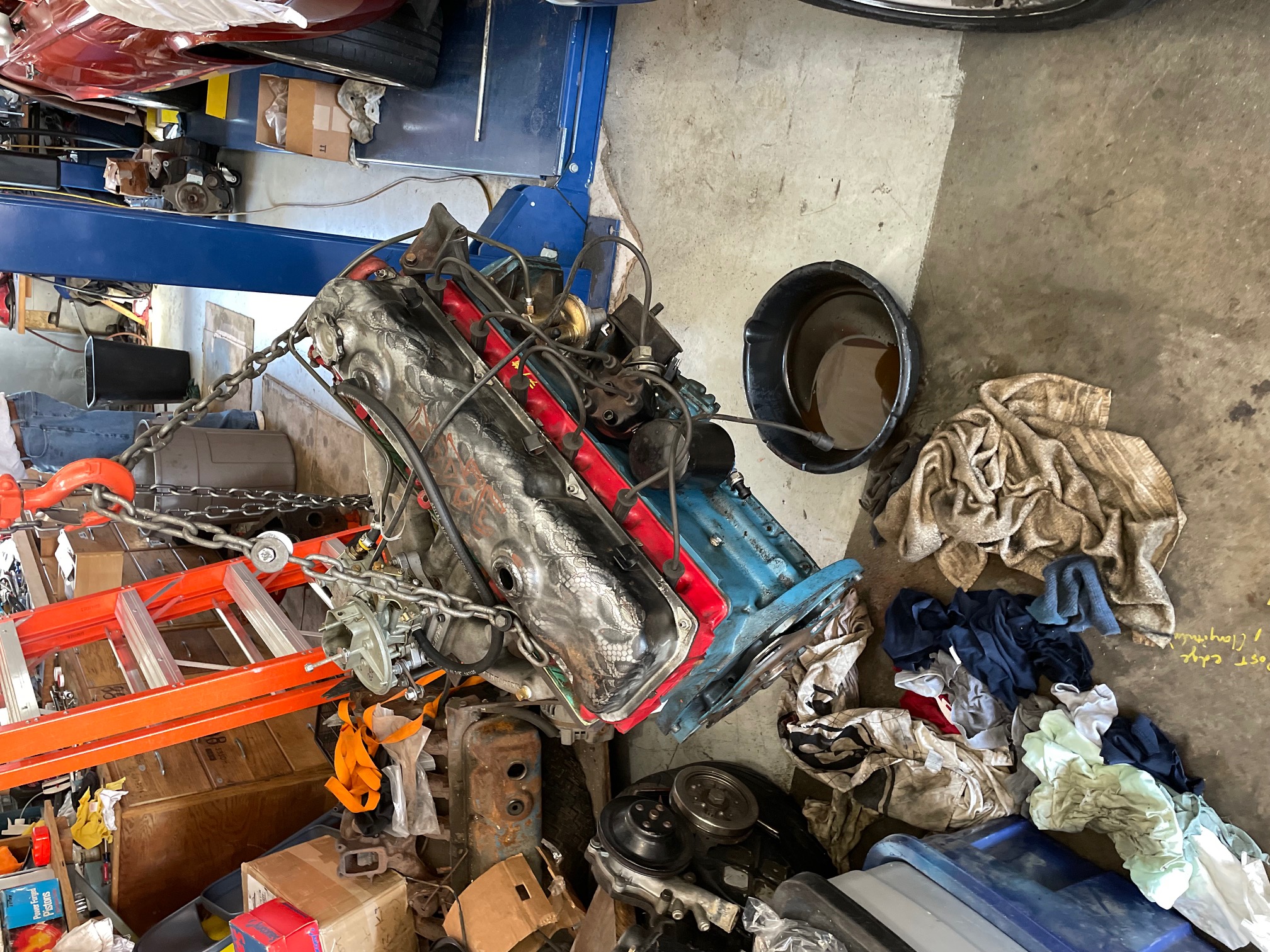

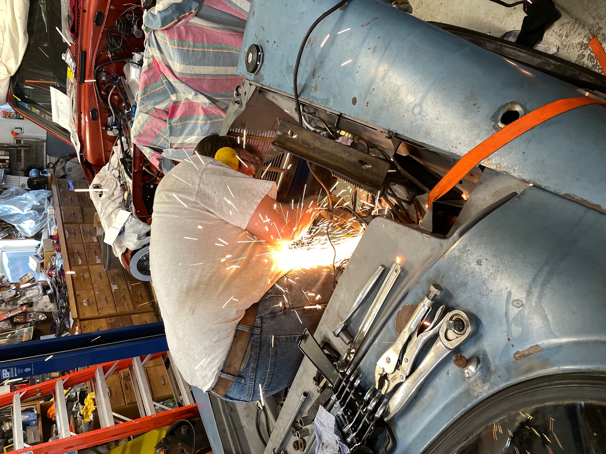

Brian, Lou and I had a fun and productive ToadRacer development weekend at the Madsen Skunkworks!
We removed TR Slant 1.5 (original engine raced at Sebring with a slightly improved head raced at NCM).
And installed TR Slant 2.0 (all new engine with much better head, cam and more compression) with same induction setup for now.
We got it running and backed down the driveway and back into the garage. Tuning with the new power to commence sometime before the race at CMP in late April.

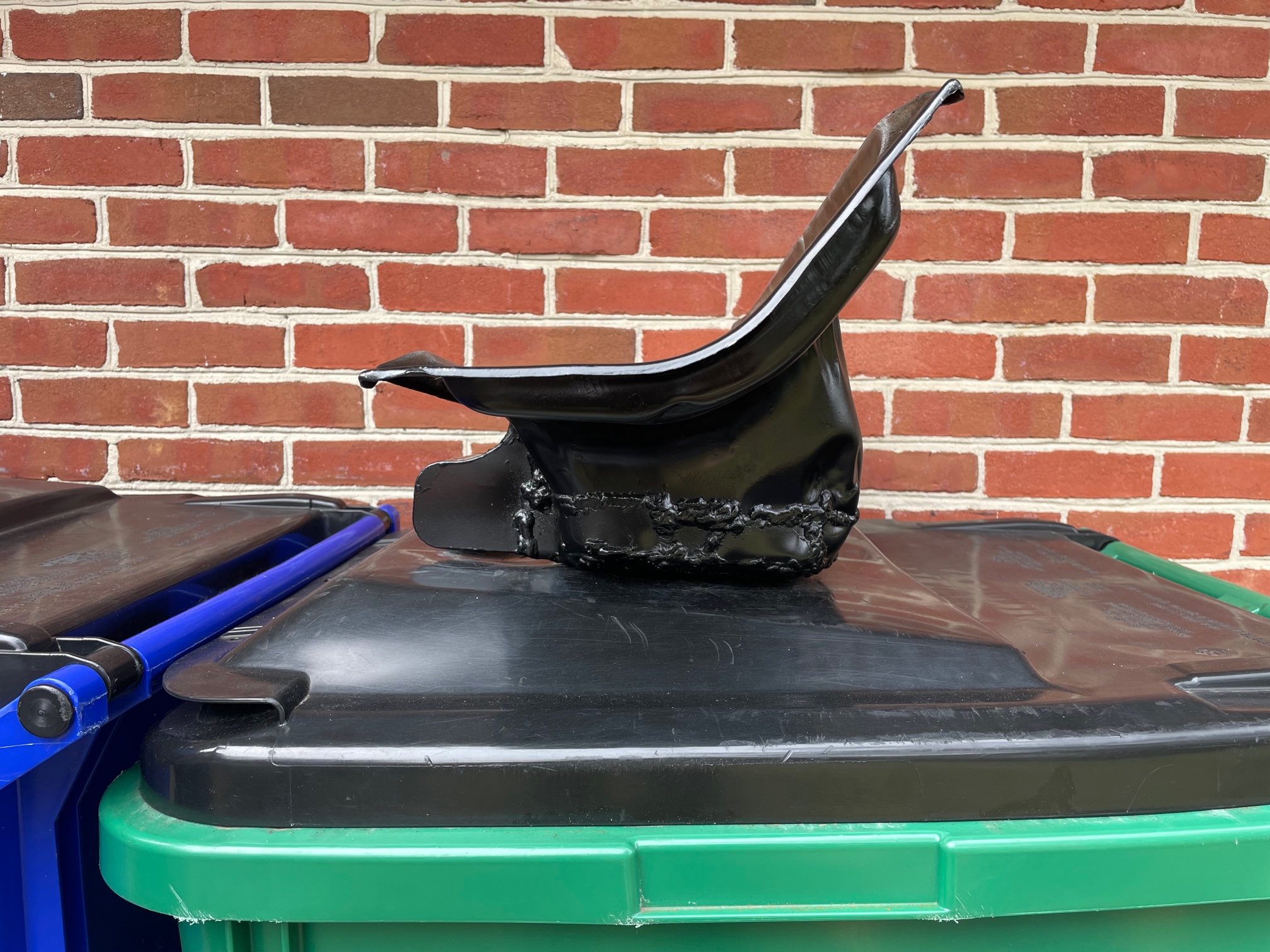

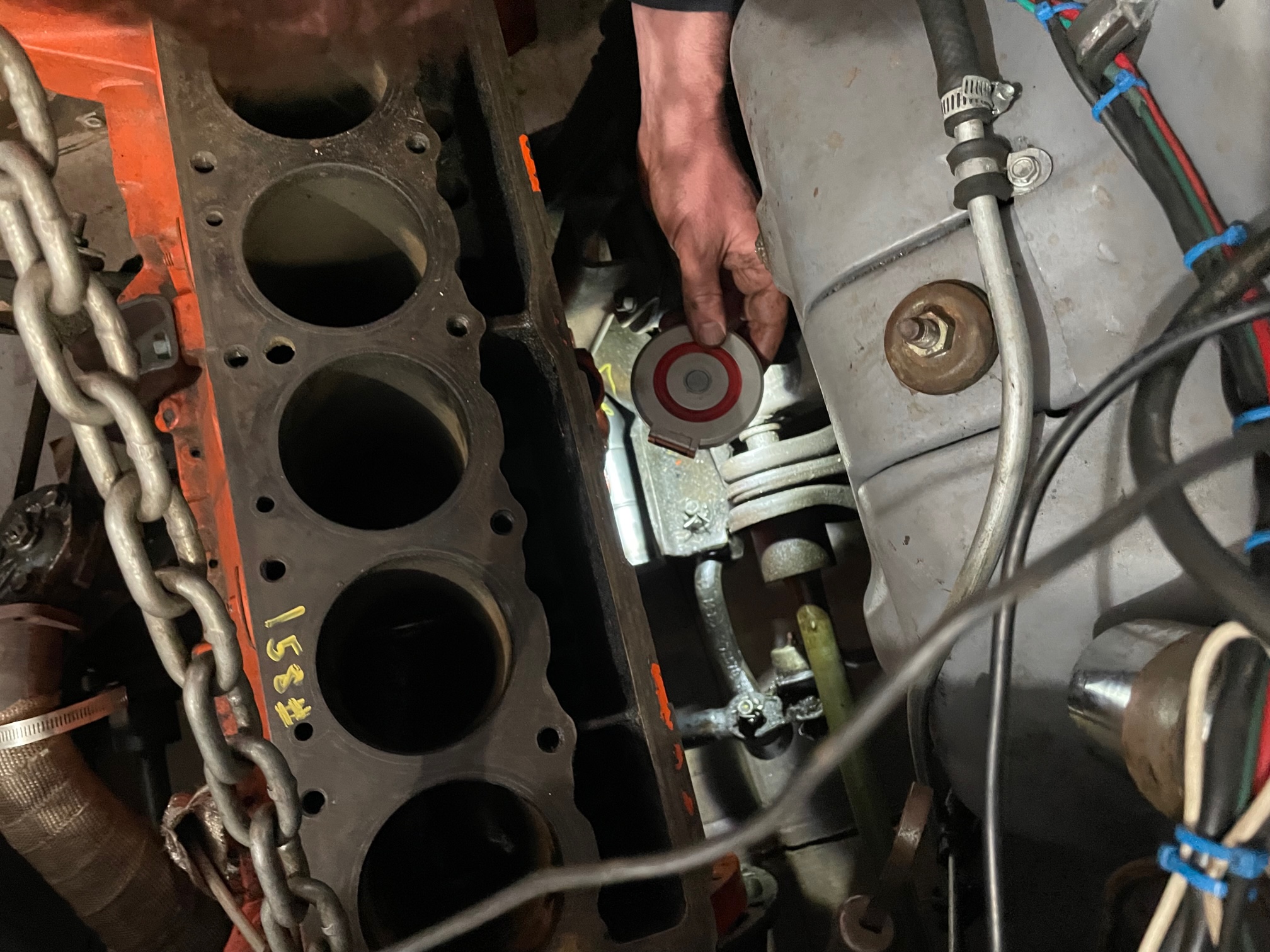

Lou built a new oil pan that is dropped about 3/4" with a Speedway kick out for increased capacity and ledge baffles for better oil control.

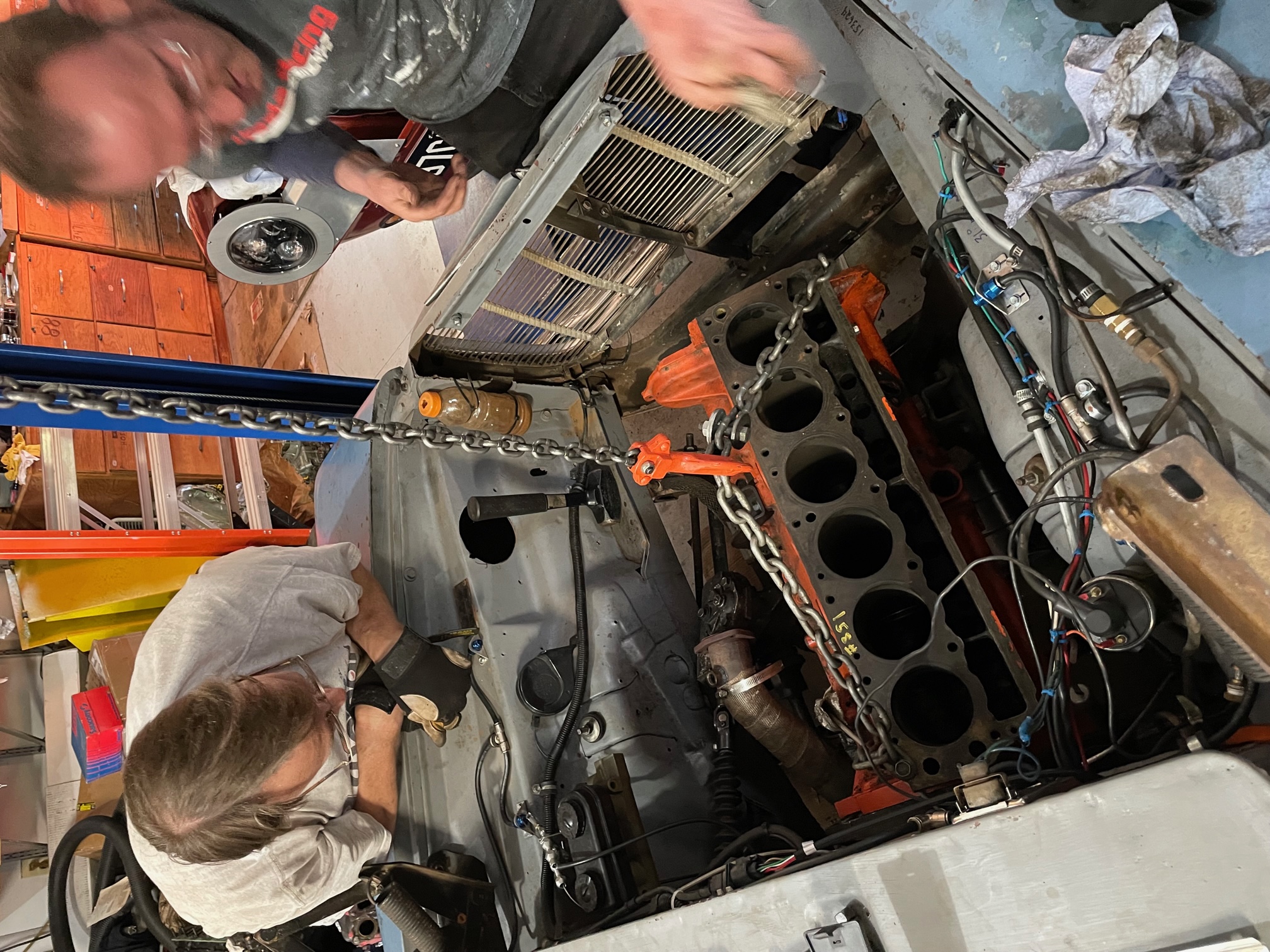

The kick out required us to notch the K frame just a smidge near the idler arm.
Pictures are worth a thousand words, so...
[[ WARNING!!! "Taco Pics" attached. My phone just decides willy nilly which photos to rotate. I ain't fixin' it again... :roll: ]]
1. No making fun of Lou's welds! He's a Chemistry Perfesser, not a welder! We leak tested the oil pan and called it A OK. :wink:
2. OSHA (and the fire department) were on stand by during Brian's Notch Notchy Surgery... No animals were harmed in the filming of this episode. :wink:
TR Slant 1.5 removed (Now Backup motor)

Brian "the Butcher" Mimken
:shock: :shock: :shock: :shock:
