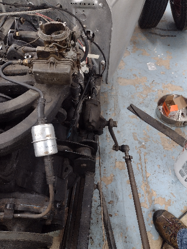

Here is what I am working with for space so far. The steering box is going to be moved more under thet starter so thats not an issue. Headers would be neat but for now I will just hog out the stock manifold opening and work with that. But i'd still like to keep an eye out for some headers if I come across a pair nearby.
