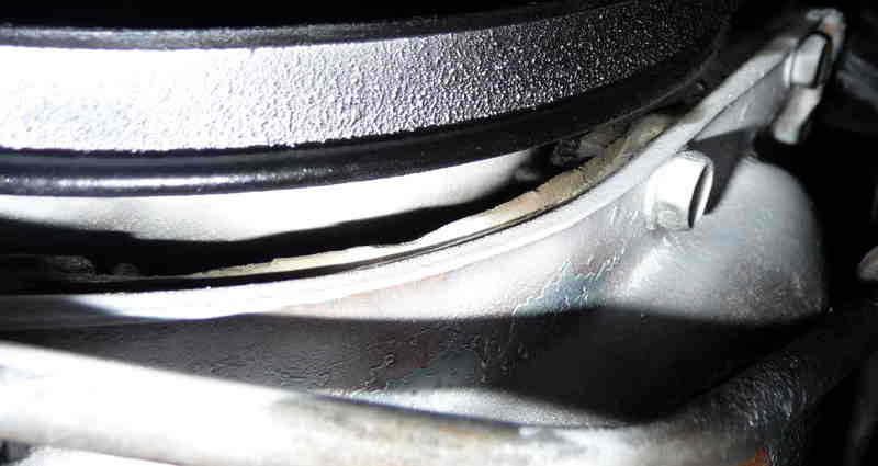

The lower rail pan gasket is bulging out at both ends and along its run in one place. Here’s a view of the front end, before i started messing with anything:

So yesterday i did the dance of getting new oil + filter, fresh new 95g tube of Permatex 82180 Ultra Black, etc. for the job. Drained out the oil + removed the filter as usual with the engine nice and warm. Gave it hours to drain, then went back to start cleaning out the gap, knowing from the wisdom here and many other places that RTV isn’t going to adhere well (or at all) to oily surfaces.
Here’s where i may have really screwed up. It’s always looked to me like there was nothing other than RTV in that gap, which would not even slightly surprise me given what the previous owner did or allowed to be done and the decades i’ve spent undoing the corner-cutting. So i dug and i dug and for awhile all seemed good until i pulled out a big piece and looked carefully: cork (or similar) gasket, that i just wholesale tore off. Here’s what i dug out before i stopped (Ultra Black package corner shown for scale; apologies for the poor focus):
I stopped digging but kept solvent cleaning, using cotton swabs to get as deep into the gaps as possible, all the way along that lower rail and as much as i could near the corners with the end rubber gaskets in place. Took a long time and a lot of swabs, but eventually it was as clean as humanly possible. Getting dark, so gave it overnight for every trace of solvent to evaporate.

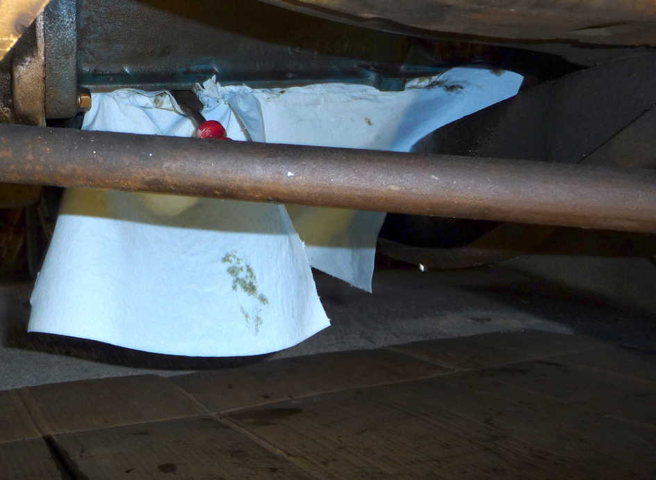

This morning i came out to set up to apply the Ultra Black, and to my great dismay found a line of oil pretty much all the way along that edge. How long does it take for these engines to finish draining down, so that edge will stay clean? Wiped down the edge again with a shop towel (one of those blue paper tear-off roll kind), then mostly as an exercise in futility, i used a shop vac crevice nozzle to suck out what i could, which seemed to do very little. Unsure how to proceed, i stuffed clean blue paper shop towel edges as far in as i could along the whole length (other than where the old chisel is holding the gap open). Very little to show for it after half an hour:
It’s now several hours later and i just went and looked again, and it looks exactly as in the photo. Would have thought that the towels would wick out whatever oil is still draining down and passing by and/or sitting there inside.
How does a mere mortal get that edge to stay clean and dry long enough to properly apply something like Ultra Black and have it cure and adhere properly?

PostPosted: Thu Jan 27, 2022 4:05 pm
Joined: Wed May 28, 2003 9:08 am
Posts: 389
Location: Chelsea, MI
Car Model: 71 Dodge D100 64 Plymouth Valiant Wagon
If the leak is only on the side of the pan, not on the front where the timing chain cover is or on the back where the molded rubber gasket goes around the rear seal, it looks like you have enough room to slide an original gasket in.
The oil pan gasket comes in four parts, with each side just flat and simple. SO get both sides cleared up, slide in the new gasket, and you won't need any sealer at all.
This is all contingent on having enough gap between pan and block and being able to scrape a clean surface for both w/o any of the old gasket ending up in the oil pan, of course.
Hope this helps and good luck.

PostPosted: Thu Jan 27, 2022 6:34 pm
Posts: 17668
Can you let it sit for a few days, then hose it again with solvents, then apply the ultra black? That would be my best advice. Also, "The Right Stuff" is excellent and probably better than ultra black for this kind of repair. Goop it up so there is a thick bead protruding 1/4" radius from the oilpan rail surrounding the gap. It's hit or miss, but that should give you the best shot w/o dropping the pan (not easy or fun).
Thank you for this.
At this point, yes, i can absolutely let it sit a few days. Not having done this before, i’m unsure of the order of magnitude of how many days to let it sit. It’s been sitting with the shop towels in it since yesterday, and i’ve yet to look today to see if they’re absorbing anything visibly.
I did read about The Right Stuff, which for sure seems to be the right stuff for professionals where time is money. My concern as a noob is that i might not be able to fully apply all the needed RTV to all the needed places fast enough before it starts setting up. Ultra Black with its 24 hour cure time requirement seemed like a slower cure, which i equate to a little more futzing around time to ensure i have the surfaces and bolt holes totally covered as well as possible without shoving stuff into the engine interior before snugging up the bolts finger tight and waiting the one (Permatex) to two (posts here) hours before tightening to spec.
Is there something about The Right Stuff that makes it better apart from its faster cure time (for those who need fast)?

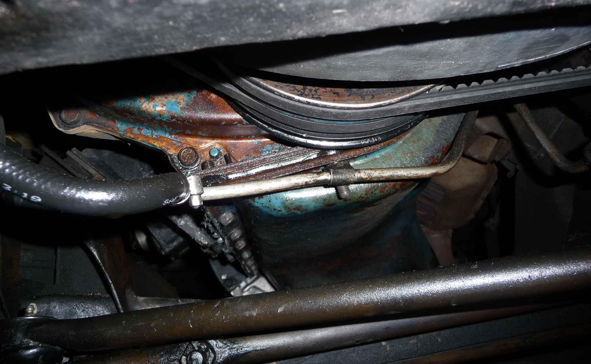

The Ultra Black sealing of the bottom oil pan edge worked! Unfortunately, a significant oil leak remains, from somewhere up in front.
Driving locally 15-20 min., 30-45 MPH: no leak, or maybe a drop. Driving 55 MPH for half an hour or so: significant oil leak—almost as much as before.
Cannot figure out exactly where the leak is, other than somewhere at the front of the engine. Here’s what it looks like today, vehicle having sat for several weeks with no effort on my part to clean anything:
A Slant 6-experienced co-worker of a friend had a very quick look, without really getting all the way underneath. He thinks it’s the front crankshaft seal.
I have not yet taken things apart to actually look. This is my only motor vehicle, so i want to have everything lined up to get it done, so it will be roadworthy by early July when i need to take a several hundred mile trip.
Thoughts on this leak? Other possible sources? Things to test while it’s all assembled? Or just start ripping into it and hope?

PostPosted: Thu Jun 02, 2022 1:45 pm
Posts: 798
Location: Rio Rancho, NM
I have a go-to way of locating the source of any leak.
Clean the suspect area thoroughly with engine de-greaser and water and let it completely dry.
Get a can of spray foot powder and give the whole suspected area a light coating of powder.
Run the engine and closely inspect the suspected leak area. Even the slightest leak will show up as darkening of the foot powder.
Don't let it run too long or leak too much or the dark area could spread so far that the source will be hard to pinpoint. If that happens, clean it all up and start over.
The foot powder will easily wash off with water when you are done.

Thank you for this suggestion. I’m getting what to me are ambiguous results. Here’s what i did:
1) Cleaned area with engine degreaser & water, mostly per product’s instructions other than allowing to air dry for several hours rather than running engine to dry, since running the engine could trigger the leak and spraying the powder on wet was unlikely to be helpful.
2) Sprayed on the powder. Here’s a Before picture:
3) Ran the engine for about 15 min. Here are the After pics:
Is this a combo leak of the front gasket AND somewhere up higher? Not sure how to interpret what i’m seeing, thus unsure how to proceed.

...Is this a combo leak of the front gasket AND somewhere up higher? Not sure how to interpret what i’m seeing, thus unsure how to proceed.
It looks like the front crank seal is leaking. Also looks like the joint between the timing cover and oil pan but if you replace the crank seal you will have the timing cover off and will need to replace the related gaskets to put it back together.
If I was going to dive into this job I'd also replace the timing chain, gears and water pump. Unless those things have low mileage.

Yep, It's one of those.......while your in there sort of things.
Do it now or do it again later and risk the sealing problems again.
