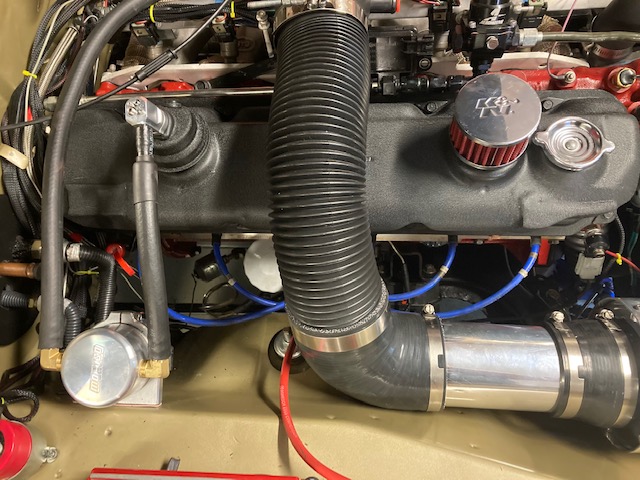

The B3 rocker shaft shims significantly reduced the travel of the rocker rollers across the valve stem tip.
But they also moved the rocker shaft up over .200 and to make that work I needed new pushrods and a modified valve cover.
I added up lifts on the ends of the valve cover for clearance and moved the vapor containing baffles to the outside of the valve cover. To make a nicer flow of the PCV piping I swapped
PCV and air intake positions.
