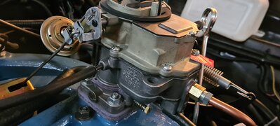

my case is no external bowl vent port on the BBD carb. this is '77 version from volare, bought as rebuilt on rockauto. doing holey 1920 to supersix conversion with super six air cleaner and other accessiories, retaining emission control. car is 73 dart sport.
Can u please help on where I should connect the canister hose, should it go to a port in the bottom of air cleaner? there is one spare port there.
thank you

For 1973 should be simple, one line to tank vent, one to carb bowl vent not used cap it off and canister purge line, which goes to purge port on carb. On bbd purge port is right between idle mixture screws

having read all the stuff I understand I connect my 3 port canister:
from left:
1 carburator bowl vent: the carb doesn't have a bowl vent port so I just I cap the port off at the canister.
2 fuel tank -> fuel tank evaporation hose
3 canister purge port -> carb purge port (between the two idle mixture screws)

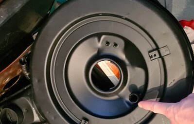

In this case any thoughts on what is the purpose of the spare port on the bottom of air filter housing (see pic)?
File comment: Carter BBD with no bowl vent port

File comment: spare port on air cleaner

That's for an exhaust air injection aspirator system your car doesn't have. Securely cap it off.
