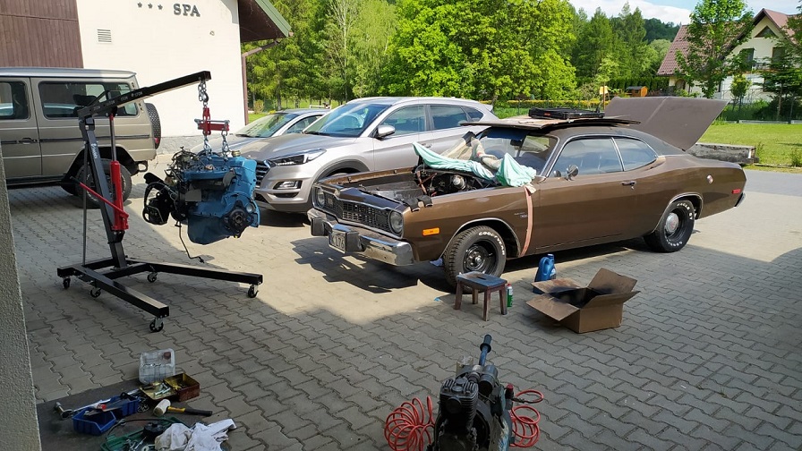

DD I took the risk and put the engine in with this unknown cam.
After experiencing some ignition problems and ending up replacing the ICU, the engine started well, keeps rpm steady and goes into higher revs promptly. The only strange thing I noted is idle vibration which is more noticable than with the previous 198 crank.
I will be testing and readjusting it over next weeks and share some more videos / photos on the forum.
https://www.youtube.com/watch?v=uEg8mplO4j8 - first engine run
https://www.youtube.com/watch?v=qLcWJEdHmH4 - first car run
On this occasion I would like to thank everyone who helped me along the way :)))
