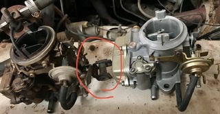

Checking with the gurus here. I have an all original’66 wagon but original carb is giving me fits. I’ve kept it, but bought a reman just to get car back on road while I figure out long term carb solve.
The reman came with no provision (knuckle) for trans kick down & throttle? Almost looks like a manual car version? Is this wrong carb, an adapter assembly available or am I totally missing the boat?
Pic attached… hopefully

That is the wrong carb. The one on the left is the correct one for a slant six with out air conditioning. They used the "twisty" throttle linkage. The carb on the right is either for a later year or possibly a 66 with air conditioning. Used a cable throttle linkage.

Thanks Charrlie. Will see if I can get swapped for correct one.
