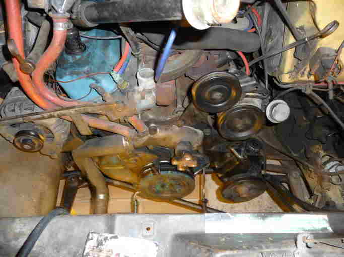

Workflow from current stage of disassembly, pictured:

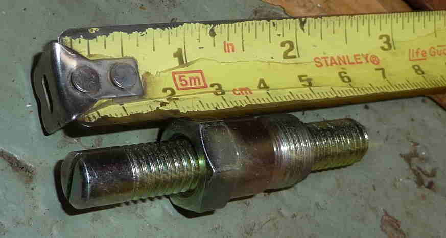

Any reason this piston stop i have is lacking?:
Worked great in 2009.
1981 B-150 short Van, stock 225, California emissions package, Electronic Spark Advance (digital Lean Burn), Non-feedback Holley 1945, AT
Driven for economy, not for speed.
PostPosted: Sat Aug 06, 2022 5:46 am
Posts: 9525
That piston stop is fine.

OK, revised answer...
I would just leave the hyd lifter in there and use the pushrod (or better yet a solid lifter pushrod since it has a cup on top instead of a ball) as your "spacer" to measure centerline. The spring on your dial indicator is so weak that the lifter should not bleed down or compress at all when measuring. I have a pile of good used solid lifter pushrods if you need one, or from a parts store or online they are only $5 or so.
PostPosted: Sun Aug 07, 2022 8:50 am
Joined: Wed May 02, 2007 4:03 pm
Posts: 78
Location: Passssssssadena, California
Car Model: 1981 B-150 original California short passenger Van
Excellent!
What i’m seeing in the pics for the hydraulic lifter pushrod is that even though it has a ball on top, there is an oil hole. Wouldn’t the tip of the dial indicator be stable on/in that? Or maybe i could temporarily put something in the oil hole, like a very small piece of cup-shaped plastic?
I’ve never looked at the actual ends of the existing lifters, nor have i yet used nor even held in my hand a dial indicator, so these assumptions i’m making may be misguided. Hence i seek confirmation.
Also, i gather that the one rocker needs to come off? Maybe that means the whole rocker arm assembly? I’d hoped that maybe i could put the dial indicator on top of the rocker arm on the side where the pushrod pushes, and that might be good enough (and would require that much less assembly). Or is it then an issue of all the pressure of the rocker arm and valve pushing against the hydraulic lifter?
