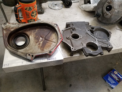

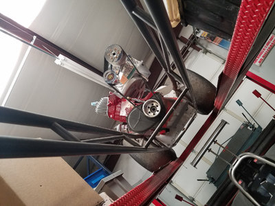

A brief visit to drop off the 6061 plate, Dave's Slant Jig, and another timing cover...

CJ, I made a 3D model of a 2pc. timing cover about 5 years ago and did a few prototype casting patterns for them I posted on here. If you need any help with dimensions and bolt locations let me know.

Hey guys. Been really busy with work. Basically, progress on the digger is on hold.
This is an iron block slant. Not sure how you'd seal up the head on an aluminum slant under boost.
The timing cover set is custom cnc'd piece. Gary machined it from a thick piece of aluminum I purchased. It's a two piece with the pumps drive off the cam.
