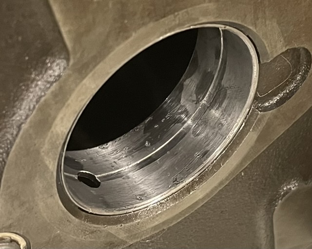

Well I know I’m a rookie at engine engine internals but I’m pretty sure a front cam bearing isn’t supposed to look like this

I doubt that cam bearing will give you any trouble. Different engines make weird noises sometimes. I wonder if you could be bottoming out the springs, if you have a non-stock cam? I would probably put it in a car and run it for a while and see how the noise goes. Hard to diagnose things on an engine that is not running.

You’d run a cam bearing that looks as bad as what’s attached above??? It looks like it was pecked at by a chicken.

I can't tell completely by the picture but it doesn't look that bad without seeing it in person for myself.
It looks more "stained" than anything. Can you catch a fingernail on it?
That being said, when I was buying parts to build my engine I took the first set of mains out of their box and they had "chunks" out of them, like some kind of coating, I'd posted pix asking what the members that be, thought at the time// and decided that for what they cost me, to just order another set and put these aside as they were cheap in the overall scope of the cost of an overhaul, not to take a chance on them.
Looking at yours being that some shop built it, I'm guessing they build all brands of engines and probably mostly V8's. I'm hoping it wasn't their first rodeo.
That said a bad cam bearing is a bad cam bearing /no matter what brand of engine. If I were assembling an engine and saw that I would have questioned it as soon as I saw it, whether out of the box or upon installation at worst. From what I see, other than that they apparently didn't lube anything on installing the cam, (which isn't real keen anyway) it doesn't look that bad.
Now, a cam bearing install tool isn't something the average guy has, but I happen to have one. It isn't hard to do, just gotta be careful lining up the oil holes correctly upon the install. And drive them in straight and square.
As long as you did tear down the engine that far for what they cost I'd probably change it but I doubt that is your noise. I'd be looking closely at the head and valves. It's very possible that once everything gets moving and oil starts getting pumped around the noise would be gone.

Yes to catch a nail. It’s bad.
Maybe it’s the picture. I’ll try to take a better one. I popped out the rear cam seal plug. The rear bearing has the same polished stain but doesn’t have the pecking marks.
Not sure what brand bearings they are as the shop supplied them. If they had a million miles on them ok… but for a new build that’s only been turned by hand ….
Ok, so bad bearings but not source of squeak. But vibration can be felt on cam gear during squeak. Back to valves? Yes running it could spread the oil out that it goes away or it could be catastrophic and make something go boom.

Am I reading right that this is a new never run engine? Any way you look at it those don't appear to be new cam bearings to me. That being said I doubt they are your noise.

Cam goes In freely except for last say 1/4” then needs a gentle tap. It will spin with a 6-8” wrench. It will not spin by hand if I put one finger on the bolt and the other on the gear locating pin
That front journal looked dry to me. I’m thinking next step is to lube the journals, put it in, maybe without the chain, and see…
Only thing left if it’s not the bearings is the valve/guides.
