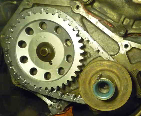

Just a guess, but oil slinger on backwards?
Shouldn’t be. Read many posts here and worked carefully. It’s dished out: outside edge away from the engine and sprocket/chain. Not all that obvious on this pic, but maybe this will help:
