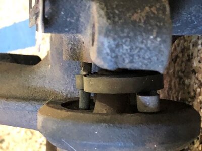

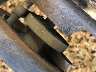

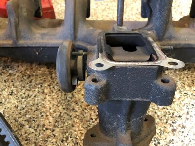

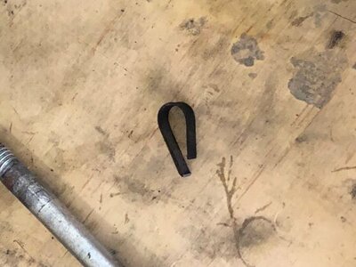

I recently got a 65 Barracuda. It has a .40 over rebuilt 225 in it. It appears to have a stock 1bbl intake manifold with a Carter (1695 ?) carb. The exhaust manifold has the word CHINA stamped into it so I am strongly assuming it is an aftermarket replacement. It has the large round counterweight on the exhaust manifold heat control valve. There are two bi-metallic springs on the control valve shaft behind the counterweight. I grabbed the counterweight and turned it (not too hard) and the end of one of the springs broke off!
It appears the butterfly valve is welded to the shaft so I can only assume that was done after installation. That makes me think I cannot remove the shaft to make this repair.
I cannot tell exactly where the broken end of the spring was previously connected before I broke it.
File comment: exhaust manifold with counterweight and spring location

File comment: close up of counterweight and spring location

File comment: closeup of spring

File comment: broken spring tip

You'e got nothing to loose by seeing if you can get the circular weight thing off.
Maybe it is pressed on and getting it red hot with a rosebud would allow it to come off? I have no idea if it has been pressed on or welded on or what..

I am located in Fairfield, CA. It turns out to be the counterweight stop that broke. Do I have to remove the counterweight to replace the stop I ordered?
I have not begun to reassemble the top end yet so I am open to replacing the intake or exhaust manifold if that is the best and most economical efficient approach.

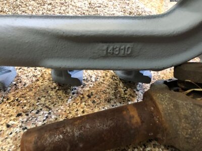

My bi-metal spring is in tact whether or not it has the proper "tension." It is the counterweight stop that ended up breaking. I found a new one on eBay and i am waiting for it to arrive. I am asking if anyone knows of a way to replace the stop without removing the counterweight. I am trying not to buy a whole new manifold when this one (part 14310 ?) appears otherwise in great shape. I do not know the brand of it, but it has the O2 port mentioned above.
File comment: what appear to be the part number on the existing exhaust manifold
