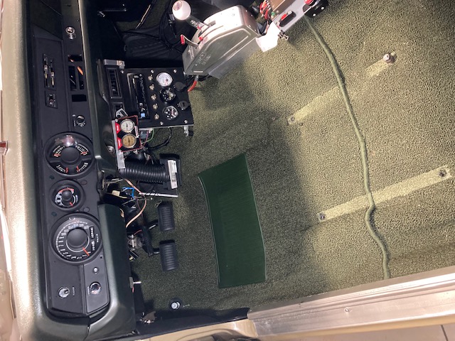

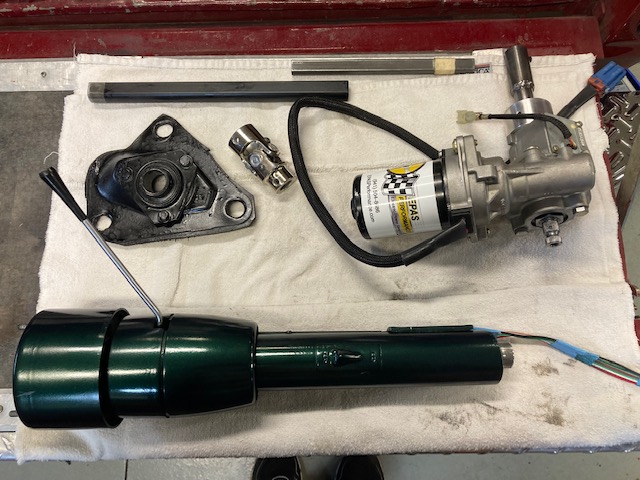

Previously rebuilt the steering column and the steering box in the 68 Barracuda.
The column has all new bearings, and the box has new internal components with a 16:1 ratio.
The steering wheel is a Mopar Tuff Wheel, it is a little smaller diameter than the stock 68 Baracuda steering wheel
Daily driving, it is fine turning the steering wheel, if the car is moving just a bit the steering effort is not overwhelming.
However, I ran the 68 Barracuda in two SCCA Autocross events, and in both, they had a slow speed chicane set up, where there were a series of three cones set up in a straight line, maybe 30 feet apart.
One really needed to turn lock to lock quickly to stay close to the cones. I could not get the car around quick enough on these slower sections. So I am adding electric power steering.
Worked today removing the steering column to get ready for the install.
An update, I have been working the EPAS install as a winter project, I need to get it done, but no real rush currently.
In working the install on this kit and speaking with the Engineering person (Geoff) at EPAS Performance, it quickly became apparent that they had never actually installed this kit in a second generation Barracuda. When I ran into an issue and spoke with them on the phone, the directions they were telling me to take, simply would not work. I asked directly if EPAS had actually installed this kit (which they say fits a second-generation Barracuda) in a second-generation Barracuda. The answer was "No, we believe it will fit, but we don't do a test install in every car that we think the kits will fit". And that's OK, being a Slant Six Mopar guy, I am accustomed to have to do some garage engineering. EPAS has been helpful, one of the hollow double D sections that would likely work in a 1st generation Barracuda is too short for a second-generation Barracuda, I spoke with them over the phone, and they mailed a longer section cut to the length that I needed at no charge.

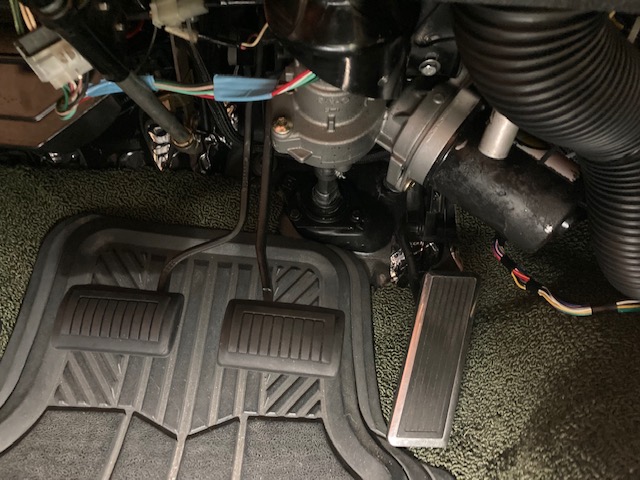

So I do have the EPAS unit installed on the steering shaft. Initially I was trying to set the power unit to the left of the steering column, like is shown in the directions for a 1st generation Barracuda, however that location either blocked the driver side fresh air vent box, or if moved up higher, interfered with the cable cam assembly that is part of the emergency brake. So I shifted it over to the right side of the steering column. To make that fit I had to cut the under-dash saddle bracket that holds the steering column up and in place. I can add an extension to the saddle bracket to recover the mount.
The power unit is just above the top of the gas pedal. I have the drive side seat out to make access easier. I reinstalled the seat and verified that the location of the power unit will not interfere with foot access to the go pedal.
I did some grinding on the back side of the power unit. The way things came together it hits there on the brake rod mounting bolt, I think with a bit more clearance added I can clock the power unit up another 1/2 an inch or so.
I have powered the EPAS unit up and it does make it easy to turn the steering wheel with the car stationary in the garage. I think that this will be a nice help on getting the steering wheel around on the tight low speed chicanes that I encountered while autocrossing last year.
I need to
1) fab up brackets to hold the power unit stationary with the steering column.
2) do the final assembly of the column with Loctite on the set screws
3) mount the electronic control box and finalize the wiring.
There is still so effort to put into this, but the tricky parts are done.

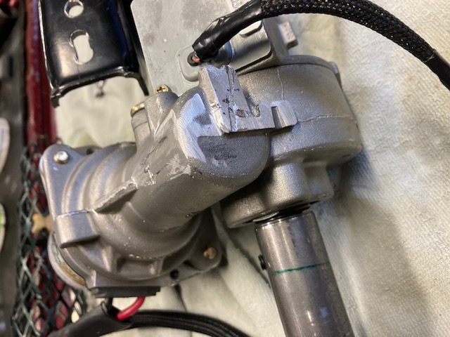

Incremental progress:
The motor assembly needs to be held firm with the steering column, so steering inputs via the shaft are fully read by the torque sensor.
Welded extensions on to the existing column mounts, then tapped the motor hub and bolted the extensions to the hub so the motor and the steering column are rigid together.
That all fits nicely with in the steering column mounting bracket.
I also shortened the upper steering shaft an inch. That moved the motor assembly forward and eliminated the close fit between the brake rod bolt and the back of the motor assembly.

Drove the 68 Barracuda out of the garage today, with Electric Power Steering!
There is potentiometer that allows one to adjust the amount of power assist delivered to the steering column.
With the dial full left, there is no power assist, moving the nob to the right increases the assist incrementally.
At full right, the assist is like a big Buick of back in the day, a butterfly could turn the steering wheel.
The Mopar A body kit is complete, but it is not a 100% bolt in without modifications. The existing column is cut down, I re used the existing steering column fire wall plate and mounted the included lower steering shaft bearing to the OE fire wall plate. The fire wall plate included with the kit may work on a first generation A body, but it does not fit a second generation Barracuda.
One also needs to devise a way to firmly mount the shaft mounted motor and torque sensor. Just one more part of the project. The EPAS kit includes a nice universal that replaces the OE slider at the steering box. The EPAS steering column is a two piece design that has a solid D shaped bar tightly fitting inside a larger D shaped tube. That retains the ability of the steering column to adjust it length slightly in daily driving or by inches in the event of a collision.
The steering column power unit ended up being positioned above the gas pedal. It does not in any way interfere with foot access to the gas pedal. But If I was doing an install with the dash completely disassembled, I would have been able to mount it up higher where the power unit wound not have been visible at all.

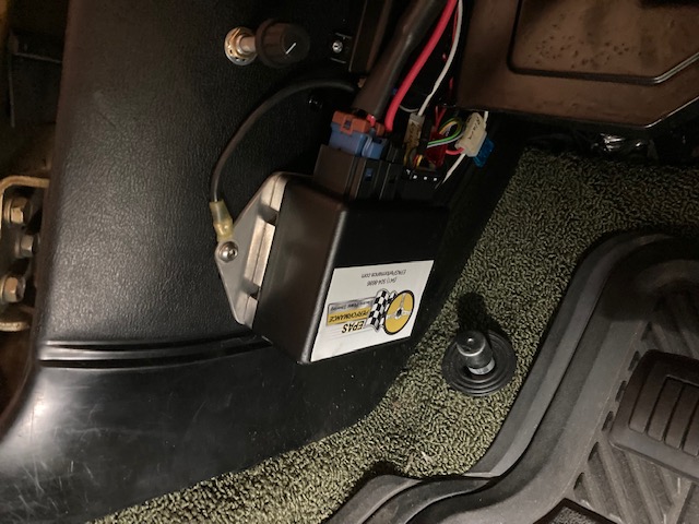

The wiring is straight forward, there is a control box that needs to be mounted and two wire connections, one light amperage wire that activates an internal relay and one 60 amp heavier wire that needs to be connected for the main power feed.
