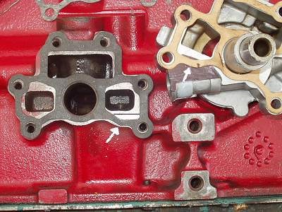

PostPosted: Mon Feb 06, 2023 10:29 am
Posts: 1475
Oil Pump Gasket Mismatch
The blacked-out area shown is the place where the casting is different on some of the 5-hole pumps and you can see a small "gap" where there is no flat area on the pump, needed to compress the gasket to make a seal.
All the gaskets are cut the same so don't waste time looking for that "special" gasket.
Cut a small wedge of gasket material and glue it down in the area below the line shown in the close-up shot below. Cut the gasket material from the "6th hole" area that is not used by the 5 hole pump.
Glue in a small section of gasket material below the line to complete the seal.
