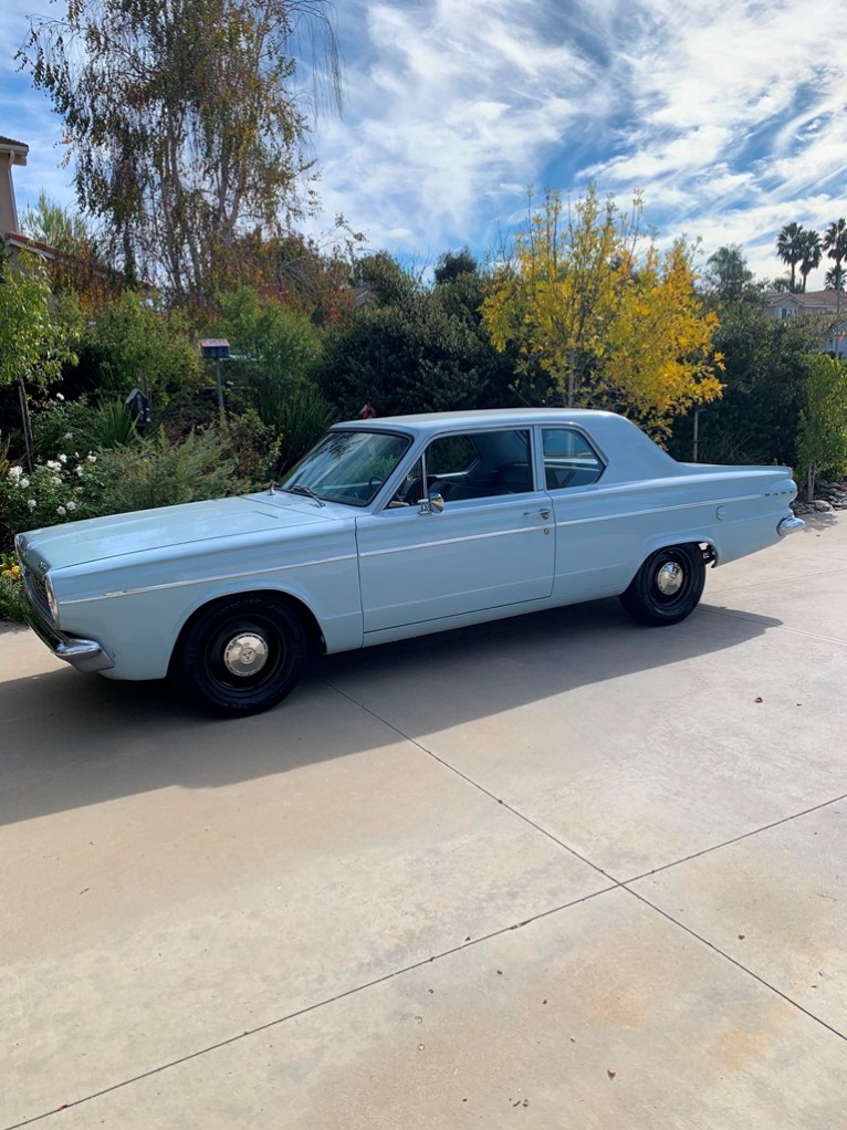

I have a 1965 Dart with the 225 engine. I had the engine rebuilt and it is .030 over. I have a Oregon Cam grind #819 (.436 Int./.436 Exh) I have a Super Six 2 barrel intake. I am looking for some input/recommendations on a carburetor. I have already run my Lokar cable linkage and my Kick Down. Per a quick CFM calculation it looks like my engine needs 271cfm for a street engine and 351cfm for a race engine. I was originally thinking of running the Super Six intake and stock exhaust manifold, but if a different intake and headers are a good gain I am not against it. Thank you for your time and input.

Nice Dart!

That's a good lookin' Dart!
