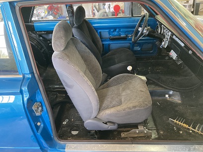

The process has begun! Removed the lightweight race seat and installed the Neon Seats I had in the attic. Probably added 50# of weight so I may not even be able to run in the 12's. But I can take my wife for a spin if I want to. :D :D Just as soon as the RH side seat belt assembly gets installed. Now that all the brackets are done and mounted, I'll removed them and clean them and paint them black. Clean the seats and finish dying them black also.

The second seat is mounted and they are both dyed black. Passenger side shoulder belt kit will be here in a couple days.

What does the dyeing process involve?

It is just a simple spray can process. I think it was "duplicolor" brand. I went from Gray to black and just made sure I went at it from different angles.These seats had a kind of "brushed" texture and the texture is a little stiff until it gets sat on a few times. I actually took a small soft brush over the seat as I sprayed the 3rd coat onto the seats. For 15 bucks they look great. I'm not sure how it would work going from a darker color to a lighter color?
