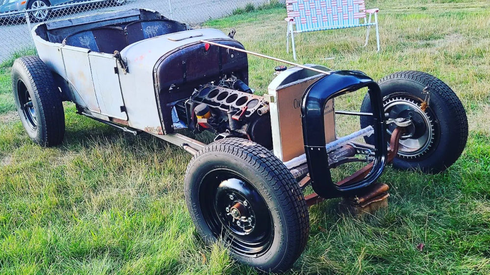

Patrick cut the bottoms off a couple of cheap reproduction '32 grille shells and tacked the tops together for this nose. The hood is going to be loooong.

Progress has been slow, as it tends to be on unusual (complicated-PITA-but-still-fun) projects, but we're still at it. The first pic shows the recently-made 16Ga driveshaft tunnel/armrest and 18Ga trans tunnel. See the long door openings? The stock doors on these things work fine if the steering column is at the original angle and the seat is at the original height. Drop the seat, and slant the column, and suddenly the steering wheel blocks the door. The usual solutions are to become an amateur contortionist or to pop the wheel on and off all the time. Pat decided to stretch the door openings, fortify the subframe around the seatback to compensate, and cut/weld four regular doors into two long ones. It's been a LOT of work, but we think the long doors will look cooool. The circle shows a fit/alignment gap we fixed after the photo was taken.
The second pic shows our current problem: To get a nice slope on the hood, we're mounting the radiator low. That puts the engine fan high and to the left (as seen by the driver) of where we'd like it. Even if we use a 13" fan, we're gonna bite the radiator inlet hose. (We could hide a pusher fan in the nose, or use an electric fan/shroud in the engine bay, but we're trying to make this look like an early 1960s build.) What I want to do is make an adapter and stick a fan to the crank. We have enough ground clearance for it. Do you know of anyone who has done this before? Their input would be very helpful.
The alternator won't sit quite so low/inboard. I'll add an adjustment arm to bring it up and out some.
