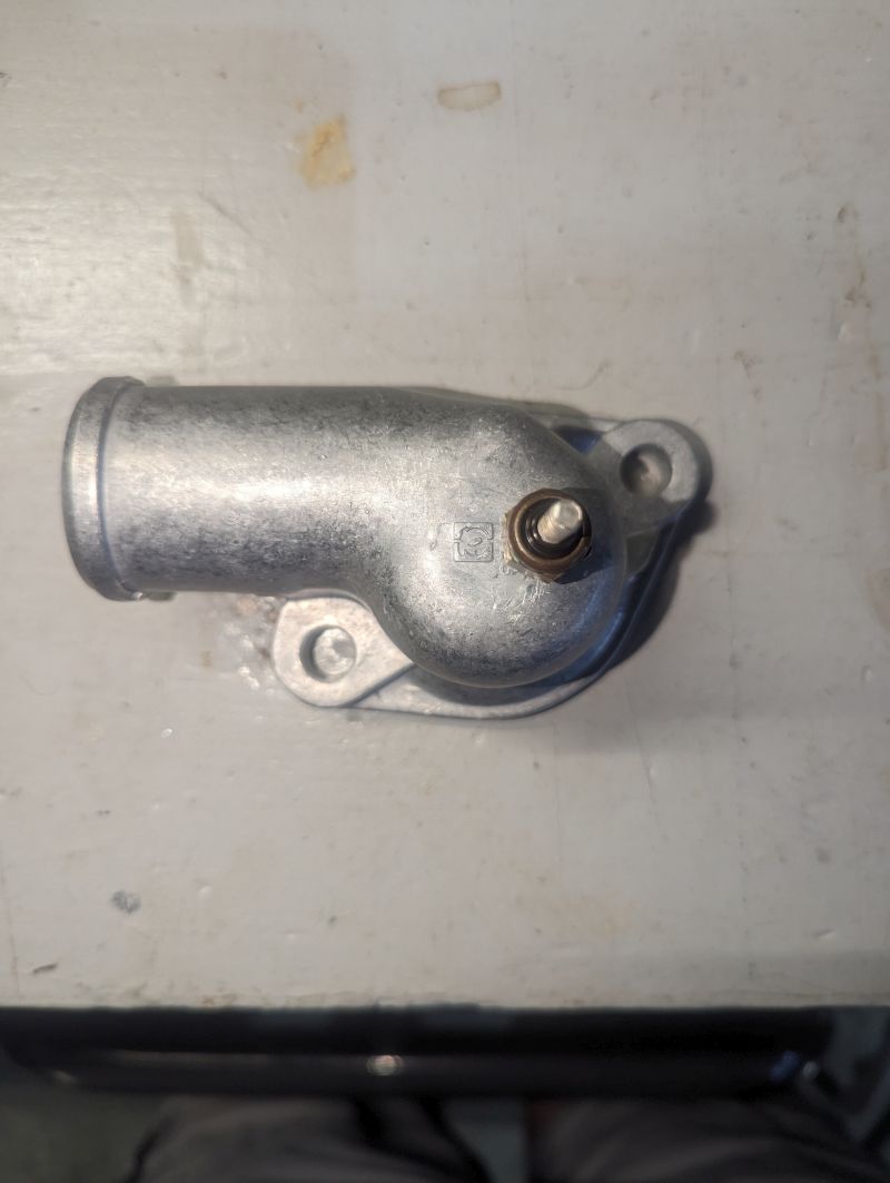

PostPosted: Sat Jan 20, 2024 10:25 am
Posts: 59
Location: Murrells Inlet, SC
Car Model: Dodge Coronet 440
I drilled and tapped the new thermostat housing I got from O'Reilly. Now I'm ready to switch it out for the current housing when I change the coolant and thermostat. Thanks for the suggestion! In the pictures is the stock temperature gauge sensor. I will move it back to the head and put my new AutoMeter gauge sensor into this new housing.
Jon

PostPosted: Sat Mar 30, 2024 10:03 am
Posts: 59
I finally got done with this job. I was waiting for a non-busy day with nice weather to work outside. See the pics. New thermostat housing with aftermarket temp gauge installed. I also switched out the thermostat 180 for the 160 that was there and replaced the coolant. Both gauges work fine, one on either side of the thermostat. Thanks all for the suggestions.
