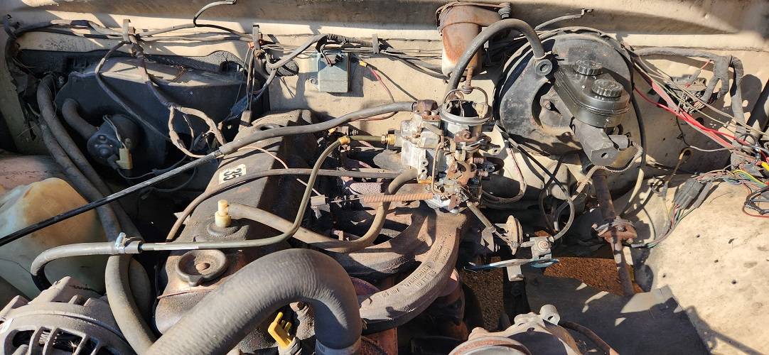

Rebuilt the Holley 1945, accelerator pump was still iffy at best
Removed Holley 1945, installed with an adapter a Carter / Holley BBD from the 318 in my Dad's truck onto the Slant 6, seems happy now

Removed all the extra vacuum crap related to the Holley 1945, down to just the fuel vent on the carb to the charcoal canister (Not vacuum but it's an extra hose), PCV, and distributor advance, brakes are off the manifold. Had no idea what that giant vacuum UFO octopus thing did, it wasn't hooked to anything when I got the truck, so it was gone too.

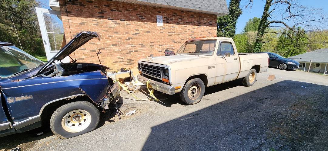

So, below is the truck, named Dale, the reason will be apparent when you see the differential. I never had the opportunity to meet the original / previous owner, but I know he bought the truck new in Burlington NJ, it was in my neck of the woods in Southwestern VA by 1992 or so, and was sold around 2011 or 2012 and there it sat until the beginning of 2023 when I bought it. Pretty much rust free save for the hole in the drivers side floor due to the leaky (non-existent) door seals. Being a northern truck it's got more paint and undercoat on the frame than I know what to do with, so there's that to fall in my eyes along with dirt, so that's great... Anyway, enough rambling, here's the truck:
PS the BBD 2bbl air cleaner does fit, hood closes, but I can't upload more than 5 attachments sooo, you'll just have to believe me unless someone replies, then I'll attach it to the reply :mrgreen:
