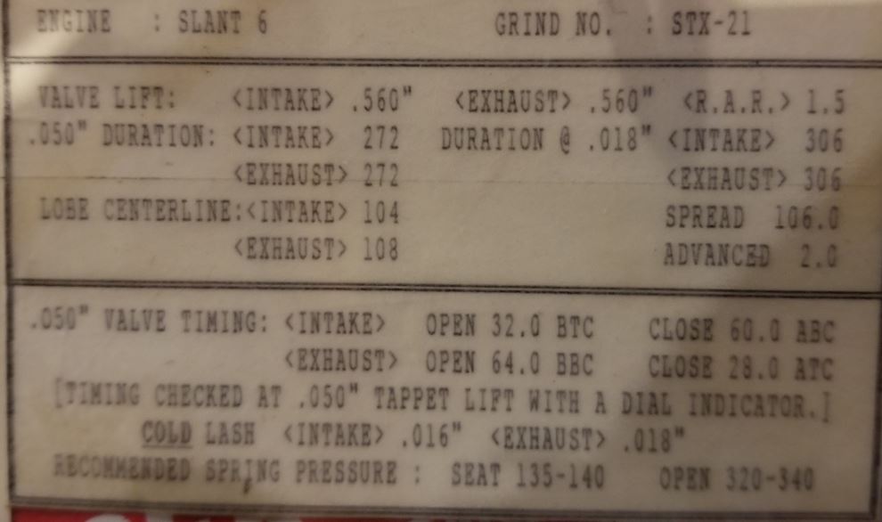

Does anyone have the specs of the STX-21 cam?
PostPosted: Fri Feb 09, 2024 11:24 am
Posts: 10403
272° @ 0.050" is some pretty serious stuff with over 1/2" lift. Effectively Larger than my Ruster cam.
Cool Stuff.
I am guessing it's a flat tappett, not a roller Lobe/ Lifter, correct?
Mine in the car now is 270 degree @ .050 and .570 lift. Most lift above .500 is just a "valve spring test" :D :D

THERE IS MY ZILLA!!!!!!!!!
