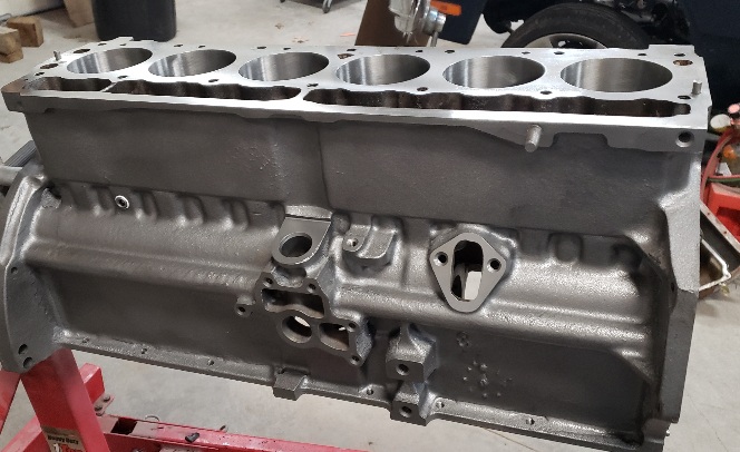

Thanks. I noticed the cylinder and lifter bores have a little surface rust. Should I go spray them with oil? (CLP)
ETA. I wiped down the bores with motor oil. Nice clean block ready for paint. I'm thinking light blue, not black. (Original color) It's a Nightwatch dark blue truck. Thoughts on color? Not red.

Did you need 60 over to clean things up? I see that's what you show in the compression ratio calculator
PostPosted: Tue Feb 27, 2024 6:45 pm
Posts: 9525
How did you get the block soooo clean?

The machine shop cleaned it and wrapped it in a bag. Pictures are from just after unloading and back on the engine stand.
