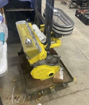

There was a guy at the Indy swap a couple of weeks ago, he had an aluminum block slant as a display piece with a sign on it that he was looking for/6 stuff. As I looked at his swap spot I noticed that he had a few pieces of a cutaway/6 head on display too.
He was the only one who had anything remotely/6 related there that I seen this year. Id seen the pix that Doc has posted back when I did mine but this was the first time I seen something like that that I could see, touch, feel. I wish I'd gotten this guys contact info. I'm wondering if he's on here somewhere, I believe he was out of Michigan.
PostPosted: Sun Mar 17, 2024 8:04 am
Posts: 2749
I wish you had gotten his info as well.
If he is looking I am sure there could be some horse trading!
Was it this guy?
