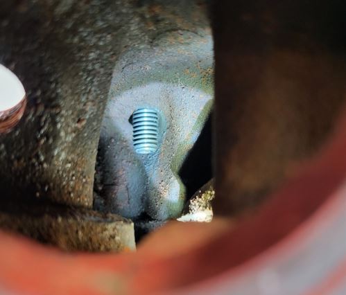

I did find the milkshake issue on the old head.
Here is a picture of the #1 rocker shaft bolt threading into the head water jacket.
It's not supposed to do that.

PostPosted: Fri Mar 29, 2024 9:30 pm
Posts: 14948
Bolt too long?
PostPosted: Sat Mar 30, 2024 3:25 am
Posts: 9486
I'm confused as to what I am seeing? My eyes and brain must be playing trickery on me. Glad you found the issue.
PostPosted: Sat Mar 30, 2024 4:45 am
Posts: 14948
Looks like the bolt broke through the bottom of the rocker stand and into the water jacket, Rick.
Never would have thought to look for that in 100 years.

Posts: 2721
That picture is looking into the thermostat boss into the water jacket.
After the PO milled the rocker shaft pedestals off, he drilled and taped 6 of the threads into the WJ.
He told me to use Blue Loctite, but I was thinking he meant to keep them from vibrating loose.
Regular blue is not recommended to seal water.
I need a permanent fix.
I could stud it if they were drilled straight. :(
Thanks, that makes more sense. Weld that puppy shut! :D
PostPosted: Sat Mar 30, 2024 1:41 pm
Posts: 2721
That is the easy one Rick!
Imagine the other six in the dark recesses of the head water jacket.
I talked to the machinist today, of course my head is not done, but he says mid next week.
He also showed me some junk chevy parts, the block he showed me had all head bolts into water.
Stock.
He said just put silicon on them.
How do you use silicon and bolt lube, like ARP goop, together?
