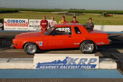

You need to talk with Mike Jefferies.
He was a long time slant six class racer.
He lives in Kearney NE but has quit racing.
