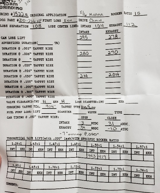

Got the cam back from OC. Here is the specs.

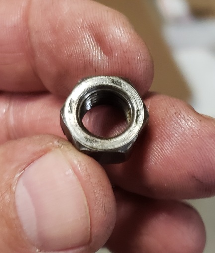

There are 4 marks on one side of cap nuts. The other side is smooth. Which side goes toward the rod? Some are shiny on one side and others are shiny on the other.
