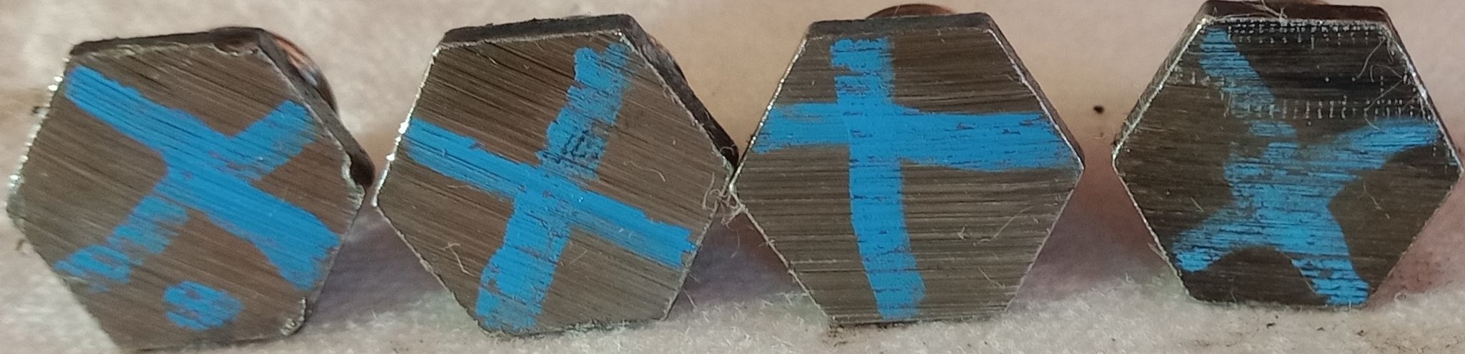

Up-date, pulled one plug wire at a time to try isolate knock. Only made knock worse. Now thinking loose oil pick-up, main cap bearing? Time to pull the engine. Removed the easy bits. Got to flex plate bolts. They were tight but not real tight. Not too sure torque spec for them, 60 ft/lbs? Anyways one had some 'discoloration/scratches' on it. (see pic) That 'could' be the knock. Not sure how to proceed. Reassemble, torquing flex plate in proper sequence and hope. Finish pulling engine and tear down.
PS. either my laptops are jankie or the site is. Alot of posts have missing text.

Posts: 2711
A cracked flex plate makes a noise like a rod knock.
Loose bolts might also.
