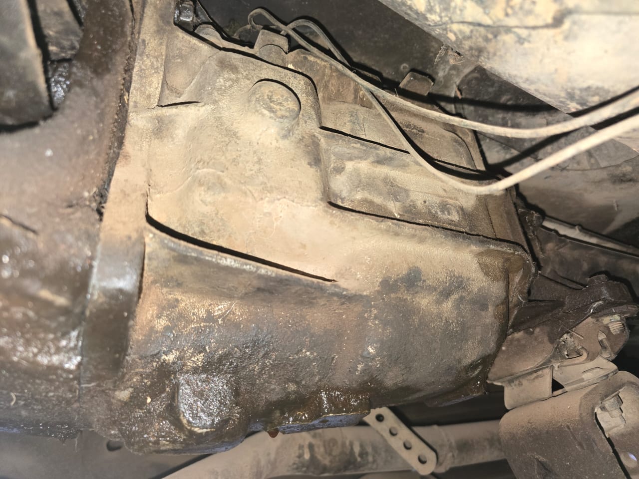

Here are the bottom pictures If you can id the transmission.

For sure not a 833 OD. That is a "top loader".

I've been having issues trying to id the transmission. All I know is that it's a ford since it has a ford clutch in it.
