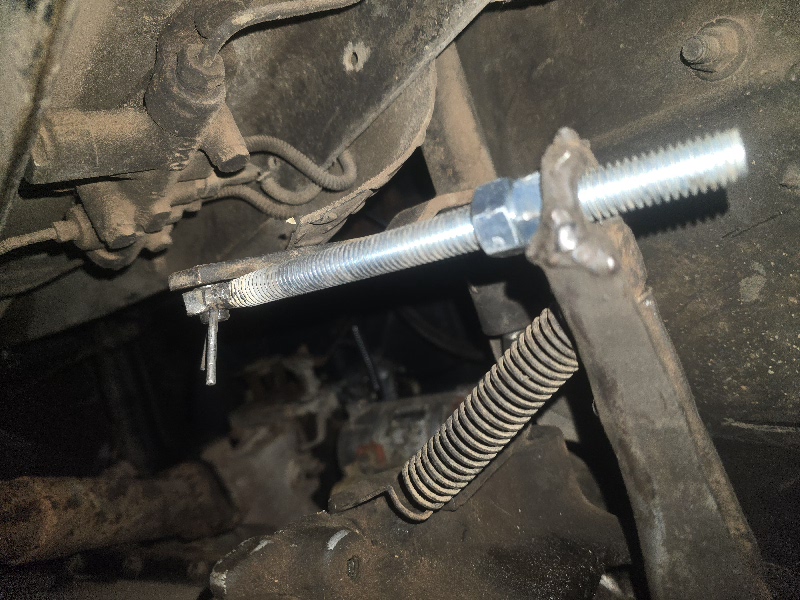

Which is underneath the truck correct. Also could someone take a picture on how it looks stock because I know mine isn't stock

Yes I did it was the exact same one. Might have changed some parts from the ram to the Ford transmission for it to work. We made a new shift linkage just because the old one was dent and had 8 nuts on it holding it in place that's the reason why I think it's that. I do know from the fsm it has a rubber gromet on their and maybe some other things. Not sure where though. Also this is what I'm working with i have about 1 inch play at the peddle. Haven't tried it out yet but the clutch seems hard and rough like it gets stuck not smooth.
