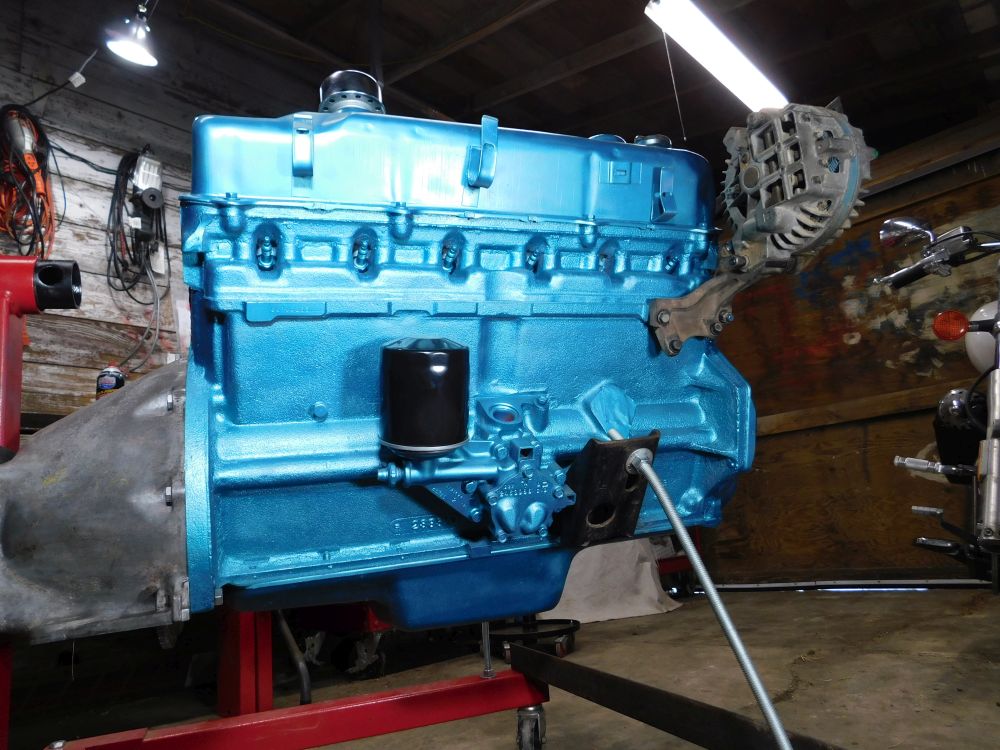

I acquired this barn find slant six engine of unknown origin.
Upon disassembly; I discovered it was in pretty good condition including bearings and cylinder walls so; I just performed a basic restoration by thorough cleaning and replacing the piston rings, valve springs, seals and gaskets including replacing the cracked and broken umbrella valve seals which is probably the reason the engine was taken out of service. Cracked and broken valve seals = Smoking engine.
When replacing seals and gaskets; I determined this engine might be a limited production version from around 1985 with less common "T" side seals at rear main seal.
When trying to identify the engine by looking at lists and charts; I never did find this particular engine ID: 6 225 2 9 5 X (see attached)
Can somebody please inform me what year this engine is and any other details that might be relevant to this particular engine?
There is also a "Mystery Port" at the rear of the head on the left side behind #6 exhaust port. (see attached)
It looks like a 1/2" diameter, "dead end" port which is about 4 inches deep and has bolt hole above it and my gasket kit does include a gasket for it but; I have no idea what this port is used for.
Maybe a big temperature sensor?
Any ideas?
Please respond.
Kindest regards; Scorch.

The mystery port is for the air injector system. Either tap it and put a pipe plug it it, or use the gasket for it as a pattern and make a cover plate.
Is it a hydraulic lifter valvetrain? That would put it at 81 or newer.

I thought it might be part of an air injection system BUT the port is a "dead end". Is about 4.5 inches deep and no air flow through it. No reason to cap it off.
It has solid lifters and adjustable rockers.

The hole at the rear of the head is not a blind hole. There is a small passage that run the length of the head and has small ports above each exhaust valve to inject clean air into the exhaust stream. Pull the exhuast manifold and check for the air injection holes in the roof of the exhaust ports.

As for the port at the rear of the head, Reed is correct. You do need to plug it.

About the year. I'll take a guess, but I could be totally wrong.
6= cyl
225 = displacement
R= regular fuel
2 9 = feb 9th
5 = `1965, 1975 0r 1985
Not 1965, has 5 freeze plugs, later engine brackets, air conditioning pulleys, two bbl intake, and air injection head. PS mounting boss has only two bolt holes instead of three
Probably not 1985: 1985 would be truck or industrial application. Has car oil pan, and you stated mechanical valve train. Crank damper is for forged crank.
I'm thinking around 1975/76: Forged crank (by damper) and no "E" in the engine ID, solid lifters, style of valve cover, 2 bbl manifold, egr and air injection. The dipstick and tube are longer that the early ones, and shorter that the truck ones. However I question the engine brackets I'm not sure of the years and I can't see the pass side, but I think that style was used from 67 until sometime in the early '70's when they went to the spool type mount.
Like I said this is just a lot of guess work and who knows What was changed over the years.

That 2bbl intake is a '78-'80 EB-welded 2-piece item.

I do not recall seeing any air injection ports when I had the valves out and cleaned the head.
That port is about 4.5 inches deep. It goes almost all the way across to the right side of the head and AWAY from exhaust ports.
I stuck a hose in the port and tried to blow through it with mouth but; no air flow to any exhaust ports.
I stuck a bore scope in the port and found no passages on sides, top, bottom or back of port.
All I see is some corrosion in port and bolt hole giving the appearance it has never been used. (see attached)

Well, don't plug it and see if you have an exhaust leak out of it when the motor is running. If not you're golden. If you do you can make the plug and cover it up. No harm, no foul.

Don't think it's 1965 because it has the later head without the spark plug wells and cups.
Don't think it's 1985 because it has solid lifters and adjustable rockers.
Intake manifold is two barrel aluminum intake I installed. Is not the original cast iron single barrel intake.
The harmonic balancer is new aftermarket part which appears to be identical to original.
And yes, did have AC compressor mounted on this barn find engine.
Original engine brackets were the spool mounts for car which I replaced with truck brackets.
Here are a couple more photos to examine.
