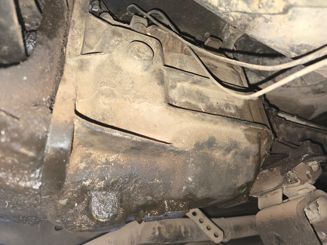

I saw that post, but only saw a picture of the shifter. Can you do a picture of the trans itself? From the looks of the shifter, it should be a A-833OD trans.
PostPosted: Fri Mar 07, 2025 4:36 pm
Posts: 9064
I don't recognize it from that picture. Do you have any more pictures? where the shifter connects, where the speedo cable connects, etc ? Is it a 3 speed or 4 speed?
I dont have any more pictures. But its 4 speed. Shifter connects in the top middle of the transmission. And it has no Shifter cable.

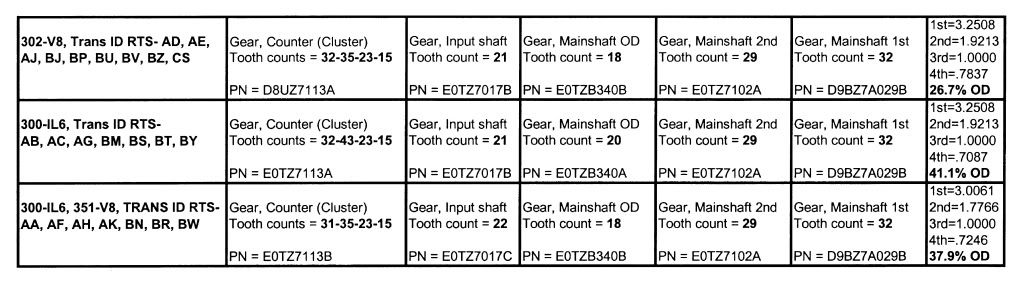

Long story short I cant identify my transmission so i can use a drive by cable to measure the speed.
It's a Tremac RTS TOD, from a 1980s F-150.
And I'm not a Ford guy, and know nothing about Ford transmissions.
Now you can go figure out what transmission drive gears they used and decide what you want to do.
– Eric
