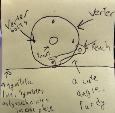

I have had good luck removing torque converter bolts by placing the wrench on the bolt at an acute angle to an asymtotic line to the torque converter edge. Stated another way, if the bolt I am trying to turn is at the bottom of the converter, and if you consider the bolt the center of a clock face, get the wrench pointing to 1-3 o'clock. This makes the force applied to the converter more linear (up) and less torsional (rotational). This means the force you apply is applied more to turn the bolt than to turn the whole converter. I am usually able to pop the bolts loose this way and then unthread them by hand.

PostPosted: Fri May 23, 2025 1:53 pm
Posts: 13431
I just be a country boy. Me didn't know I had one of them on my car. :D :D
I done masticated at tha uneeversitee and got me one of them fancy dee-grees. I made a pitcher to hep ya.
