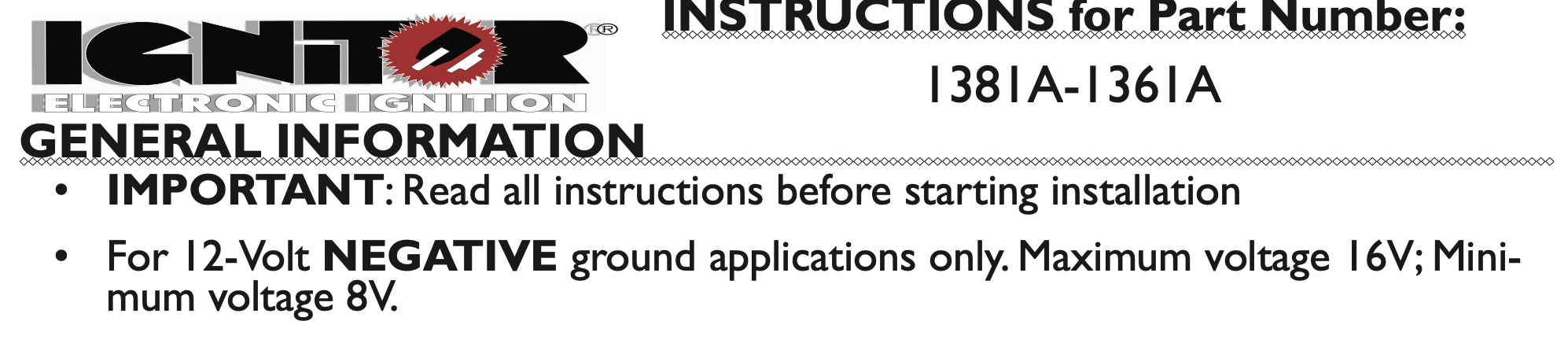

Um, not according to their instillation instructions.

OK, I installed mine a long time ago and may be misremembering the instructions. Or maybe they've changed to a note about coil resistance instead.
Matt Cramer
PostPosted: Thu Sep 11, 2025 6:24 am
Posts: 17628
I just looked at the package I bought (P-I) for a backup dist I just built a few months ago. It says minimum 3.0 Ohms for 1 to 6 cylinder engines, and to run a ballast if your coil primary has less than 3.0 Ohms. It also says maximum of 4.0 Ohms.
It does also say that leaving the ign on for extended periods can burn out the Pertronix unit. Same with points (if they happen to end up closed).
