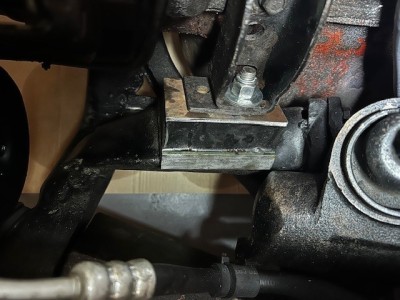

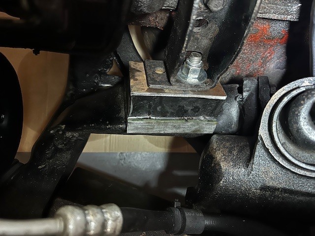

the where 12mm short... so an iron plate is now installed, since the rubber old ones where too fare gone to re-install.
The car is o-kay when driving it, but stationairy the whole car is rattling. I will have to look for rubber ones again since I am definately not gonna drive with this it's a damn waste.
The engine is so extremely smooth, I changed all fluids, from gearbox to dif to engine oil and there is no sign of any wear or metallic residu. The car is mechanicaly extremely well; but this just ruines the whole car...

12mm too short = definitely not the right parts.

only way to get them mounted right is with spacers in between..
Were they allowing the engine to sit too low in the K frame? Pan hitting the frame? I will be happy to measure mine and see how tall they are. I know that won't help you but if they are the same as mine then something else is going on. Sorry for your troubles.
PostPosted: Thu Apr 02, 2026 6:29 am
Posts: 17592
Weird. I have used multiple sets of those mounts on my 64 Dart, 66 Valiant and 62 Valiant with no fitment issues. You must have received the wrong ones. They will probably transmit more vibration, which I would not notice since I have bumpier high HP engines.
