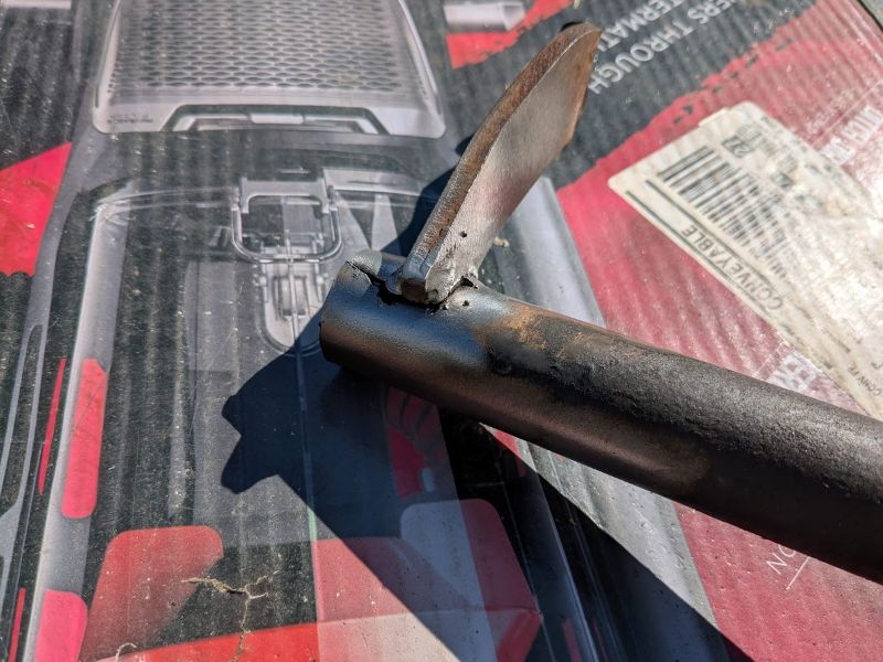

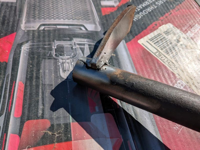

I had an adventure getting home when the Z-Bar in my '65 Dart wagon (225 with an A-903) ripped so I could no longer operate the clutch. After completely missing it (it was on the back side in the shadow and didn't seem to be flexing at all when I was snooping around, oops) and replacing my clutch and pressure plate instead (don't ask), I hammered my old one back into position and welded it up for now. I'm not happy with it though, so I'd like to get a spare that still cylindrical (mine is ALMOST cylindrical, but the tear was parallel to the length of the tube).
Anyway, if anyone has a good spare that hasn't been completely manhandled, or any suggestions of something else I could try, I'd appreciate it. (Oh, regarding the clutch...I'm not TOO mad at myself; the throwout bearing was getting pretty noisy anyway). :)

Almost all of the Pre-1967 bars will have that same shear failure The Tube diameter was made thicker after 1967?
All of my (stick) A and F body cars have had this same failure.
I am not sure if brewers has the correct one for your car.
I buy them at swap meets and slice and dice them to fit my cars.
I can Repair and reinforce them as well.
I have done this on the thinwall tube for my '62 wagon.
The link above does not show my upgrade for the '62 valiant, but I wrap and reinforce the thin tube at the failure point and then re weld the arm on.
Best of Luck,
Good luck, Greg

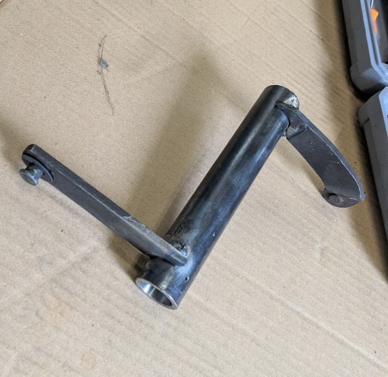

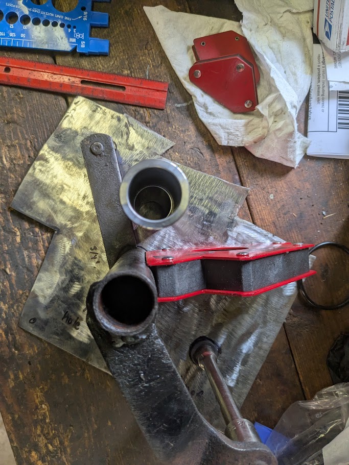

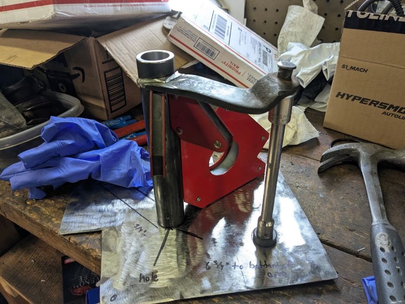

Brewer's had a nice 7.6" tube for $45 shipped that is far thicker than the original. I used the old one as a template, cut the arms off, and rewelded them using my old flux core MIG welder (the welds are ugly, but I saw signs of heat on the inside of the tube).
Unfortunately, my new LUX pressure plate seems to be making a springy, popping noise, so I may just throw in the old pressure plate when I feel like taking a day to do the same job twice.
