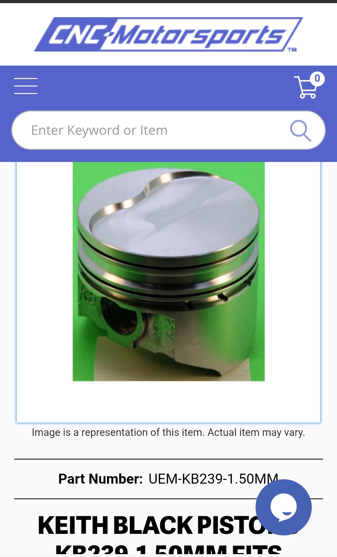

NA. No nitrous. Cast aluminum. Hypereutectic This my Mazda RX-8 that I have been working on for 4 years. Just a fun project. No racing. Just local parking lot car shows. Dutra Duals, Gill Welding port injection intake, Gill Welding exhaust, Haltech ECU, LS coils. Just something for me to inker with. I have a local engine builder building the engine. Boring to 3.445" 87.5 mm. Money is not a consideration. The KB239 plus the 7.005 rod gives me a zero deck. The modern pustons are lighter to rev a bit higher and have thinner rings for less friction.
