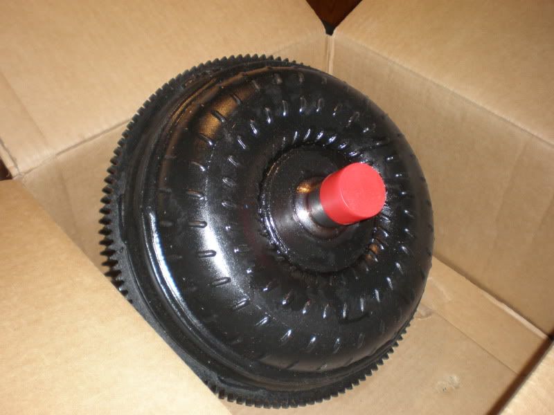

Well, the Converter from Midwest is here - 4000 Stall.

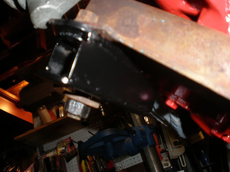

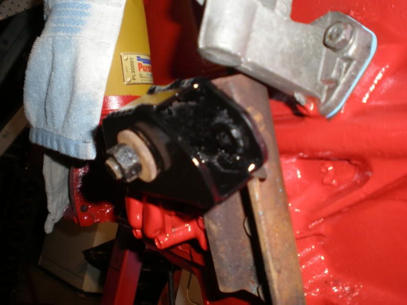

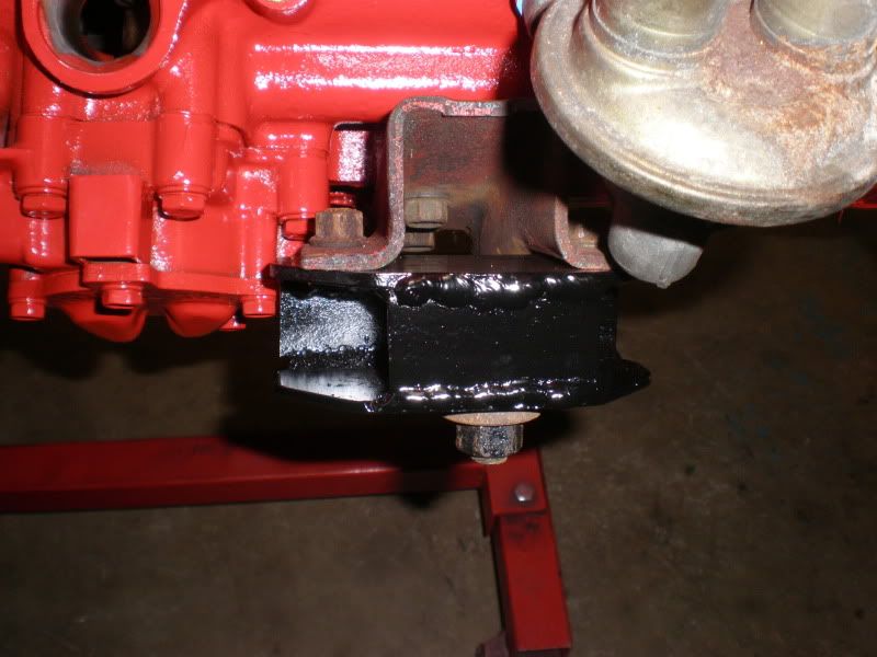

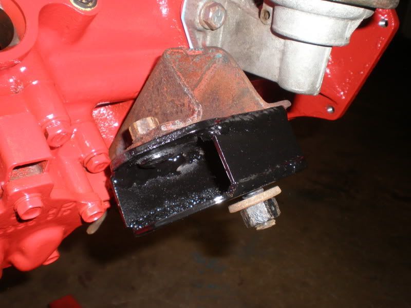

Also Fabbed up some passenger side Soild Mounts from an old rubber mount and 1 1/2" flat stock.

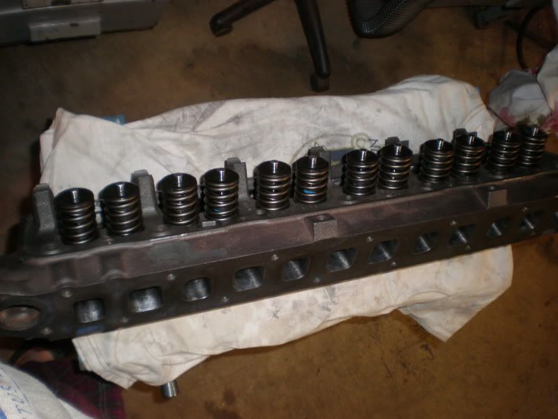

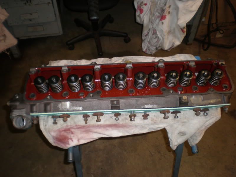

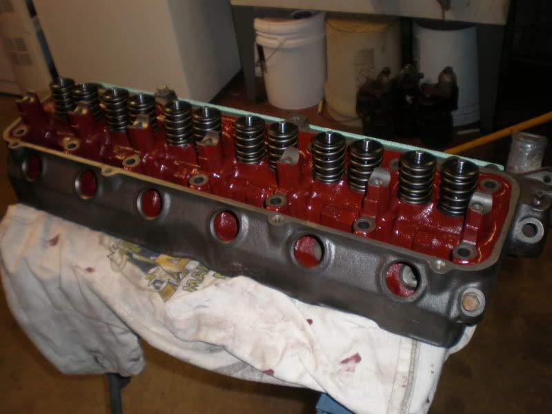

Well I had a nice big gift awaiting on my porch For the 1st day of march! The Big Valve Jeffery Head is here.
Intake Valves - 1.760"
Exhaust Valves - 1.500"
Here are some Pics

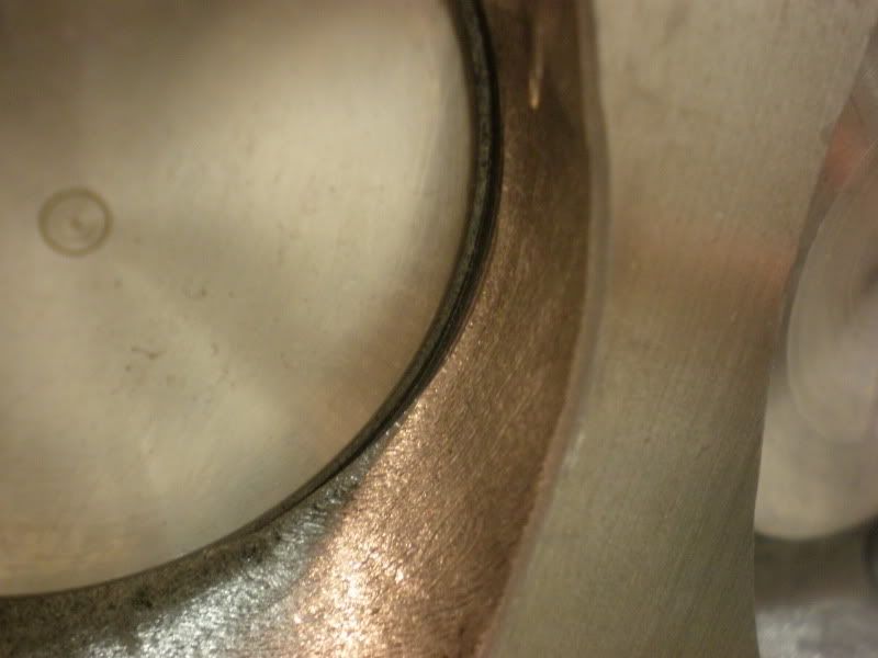

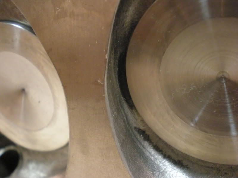

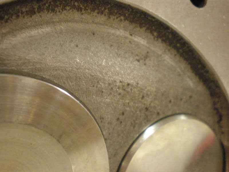

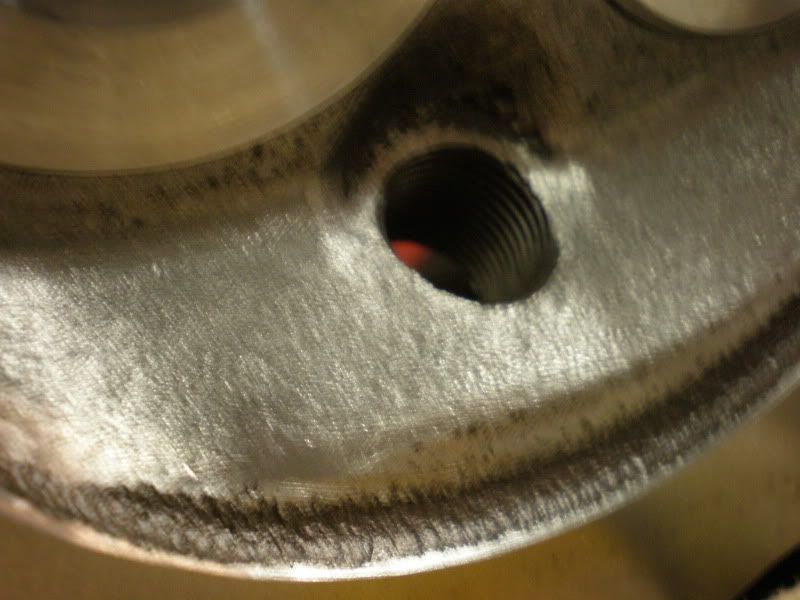

The Valves are Hitting the Pockets Just a bit as illustrated be the Pics. Same as The Guzzi Engine. I will be enlarging these with the Dremel.
Both sets of pistons have the issue - (intakes toward the front and rear)

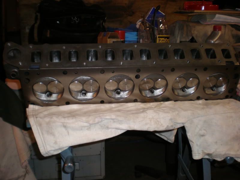

Head Arrives

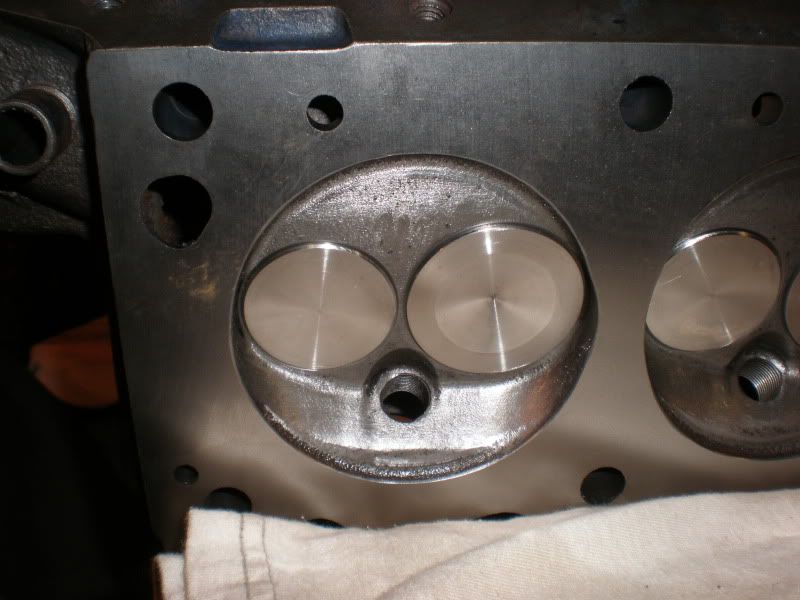

Chamber Shot

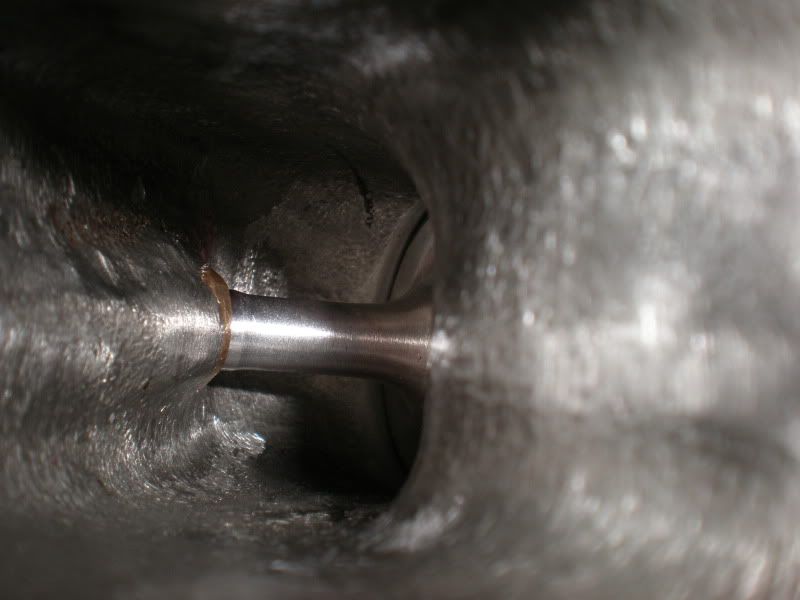

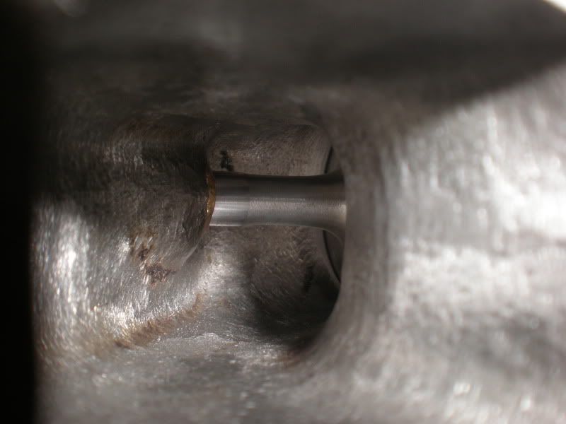

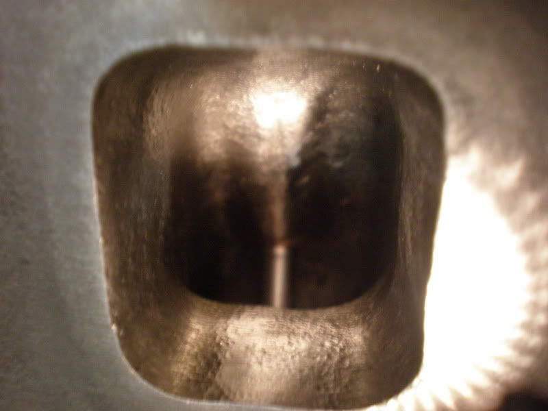

Intake Port
Intake Port
Intake Port

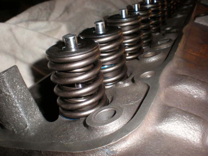

Springs
Closeup of Springs - Retainers

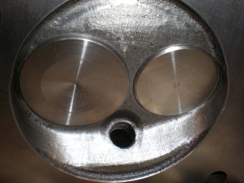

Chamber View
Closeup
Chamber Closeup
Unshrouded Intake
Unshrouded Exhaust

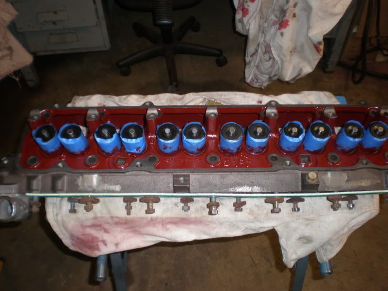

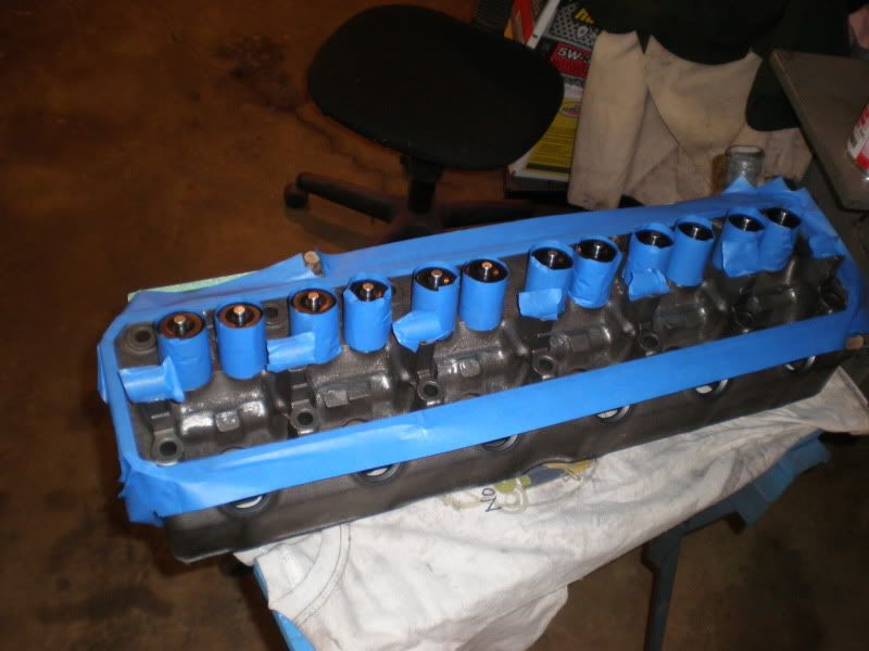

Masked for Glyptal
Glyoptal Applied to inner castings
Glyptal Done
Another Shot
Piston #1 Valve Pocket interference - 1.76" intake
Piston #1
Piston #1
Piston #6
Piston #6
Piston # 6

I keep meaning to ask what, what valves are these? They appear to have a long tip length. Image

Hi Greg. What a teriffic job you have done to document your engine build. I made a little search for Glyptol, and found an interesting sentence referring to the legendary Smokey Yunick:
When Smokey first painted his engines he also painted the intake and exhaust ports. They were not allowed to grind them smooth, AKA porting. With the paint, many thin layers, they became smooth and increased flow rates. As he made more power and was beating everyone, they wrote a rule against painted ports.
Olaf

Yes I am aware of Yunicks' Cool Tricks!
I did not paint any ports however.
Josh These are / Were Ford Valves,
Ford Int. Valves - 1.840" / 11/32" Stem / 5.070 Length.
They definitely appear to have a longer tip than stock, I have to measure the Reatiner heights and actual valve lenghts against stock to confirm.
