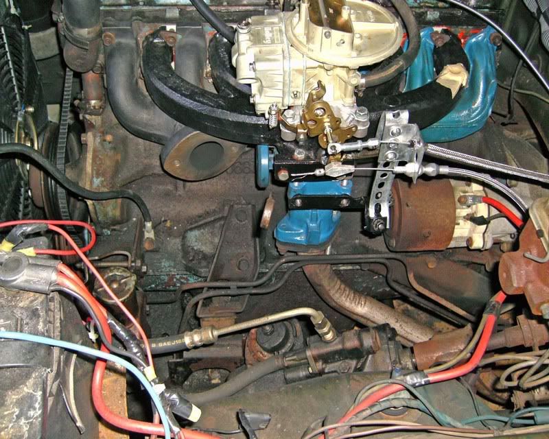

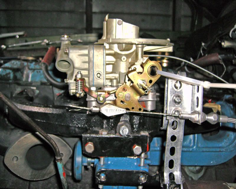

So here's where i'm at so far. I connected the transmission side of the lokar cable, then zip tied the throttle in the fully opened position, pulled the lokar cable tight so tranny swivel part would be all the way back, then tightend the cable to the carb. That part is done, hopefully right.
I might cut heavier angle iron for the bracket, but i'll see.

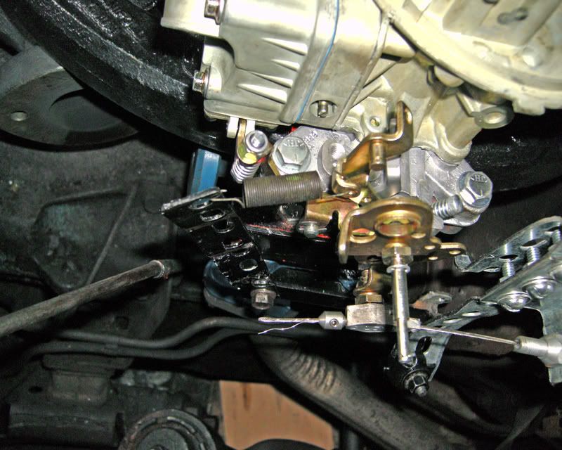

I connected a throttle return spring, and installed the holley throttle stud. The parts store messed up the order the first time around, handing me a box with a screw in it??? I had to show him on the internet what i wanted, and it took a week to get it.
BUT, since the old throttle cable was way to long and couldn't be made to work right without kinking it severely, I ordered a spectre throttle cable part # 865 3431 from jegs, and once that's connected i'll add another picture.

Connected the new throttle cable. It's a cut to fit cable, and works well.
