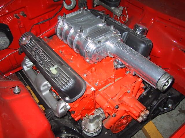

Josh- Yeah, but wht's that orange and black thing where the slant should be? :wink:

Josh- Yeah, but what's that orange and black thing where the slant should be? :wink:
That orange and black thing was an easy way to make about 400hp. It's a 1978 E58 (HP) 360 with bigger intake valves, a Crane Energizer cam and...
a B&M Powercharger. I expect about 450 ft/lbs of torque. :D

That orange and black thing was an easy way to make about 400hp. It's a 1978 E58 (HP) 360 with bigger intake valves, a Crane Energizer cam and...a B&M Powercharger. I expect about 450 ft/lbs of torque. :D
Cheater!!! :wink: :lol:

Don't make me put my 440 in there! I don't have a blower for the 440, but I do have a NOS Super Powershot plate system. :twisted: I don't think the Ford 8" rear end is going to be happy with the 360 let alone a 440, but the 2.80 gears will help it survive. It really depends a lot on the tires I use. If the tires hold less torque than the axle shafts it will live a while. If I do brake an axle in the 8" I'll just have to narrow the C-body 8 3/4 I have stashed under the work bench.

Yeah ! Lock it!,,,,,theres a breather on that valve cover!
PostPosted: Sat Jan 17, 2009 7:44 pm
Be careful........
Don't mention the B word......
Or the thread might get locked.
