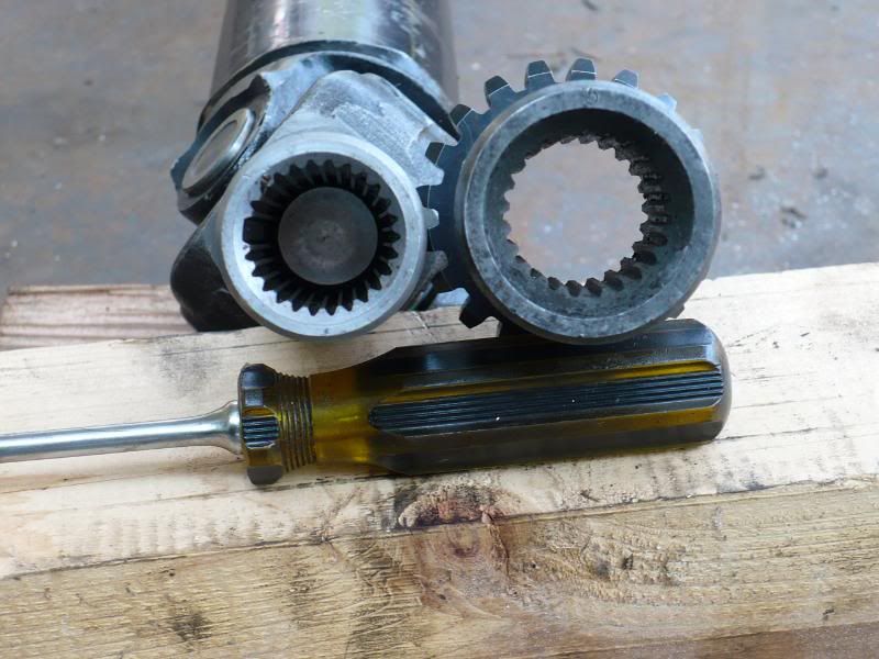

What do these have in common ??

They have an old screwdriver under them.

You win nothing, they also are setting on a block of wood looks like maybe a 4X4.

I'll take fit on an output shaft for $904 Alex!

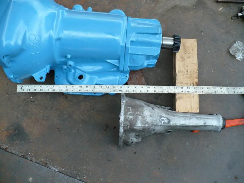

Yes, the one on the left is for a regular 904 the one on the right is for a modified 904 (mixture of Jeep/slant).
For you guys that want or need a short shaft 904, these parts are available in most salvage yards.
This one is going into a Rear engine dragster (hope to have it ready by 2013 season)
