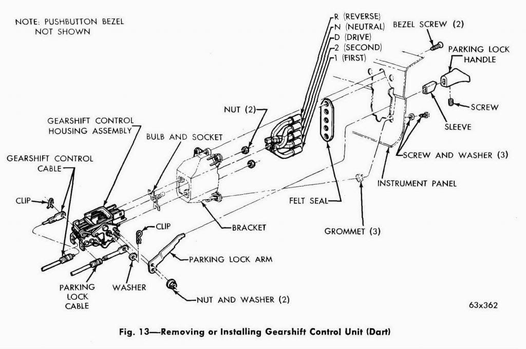

hey dan, question for you, i also have the push button tranny and my reverse button fell off in there...i managed to get the stripped bolt out to remove the panel but now i can't get the wiper button off.
how do i remove the wiper knob?
then it looks like once i get in there i am going to need to take off another layer of panel.
any advice on fixing that button before i rip it all apart? after, of course, i get the wiper knob removed.
merrymopar, the wiper KNOB is attached to the shaft of the switch with a small Allen setscrew. Then the bezel that holds the switch can be unscrewed the same as the one for the light switch.
I STRONGLY suggest disconnecting the battery negative cable, because there some bare conductors on some of the wiper switch parts, depending on the options.
Once the switches are out and the Park knob (another setscrew) is off, you can remove the screws holding the pushbutton unit to the dashboard. This drawing may help.Image
Once you have the control unit loose you can see into the bracket that the buttons work in. The buttons press onto their operating rods EXCEPT the NEUTRAL button, which has a hook into a hole in its lever. DO NOT PULL ON THE NEUTRAL BUTTON! If you break that little hook off I have no idea where you might find another neutral button. It may make it easier to reset the reverse button on its rod if you shine a bright flashlight into the bezel so you can seehow the other buttons are attached to their rods.
I hope that helps!
